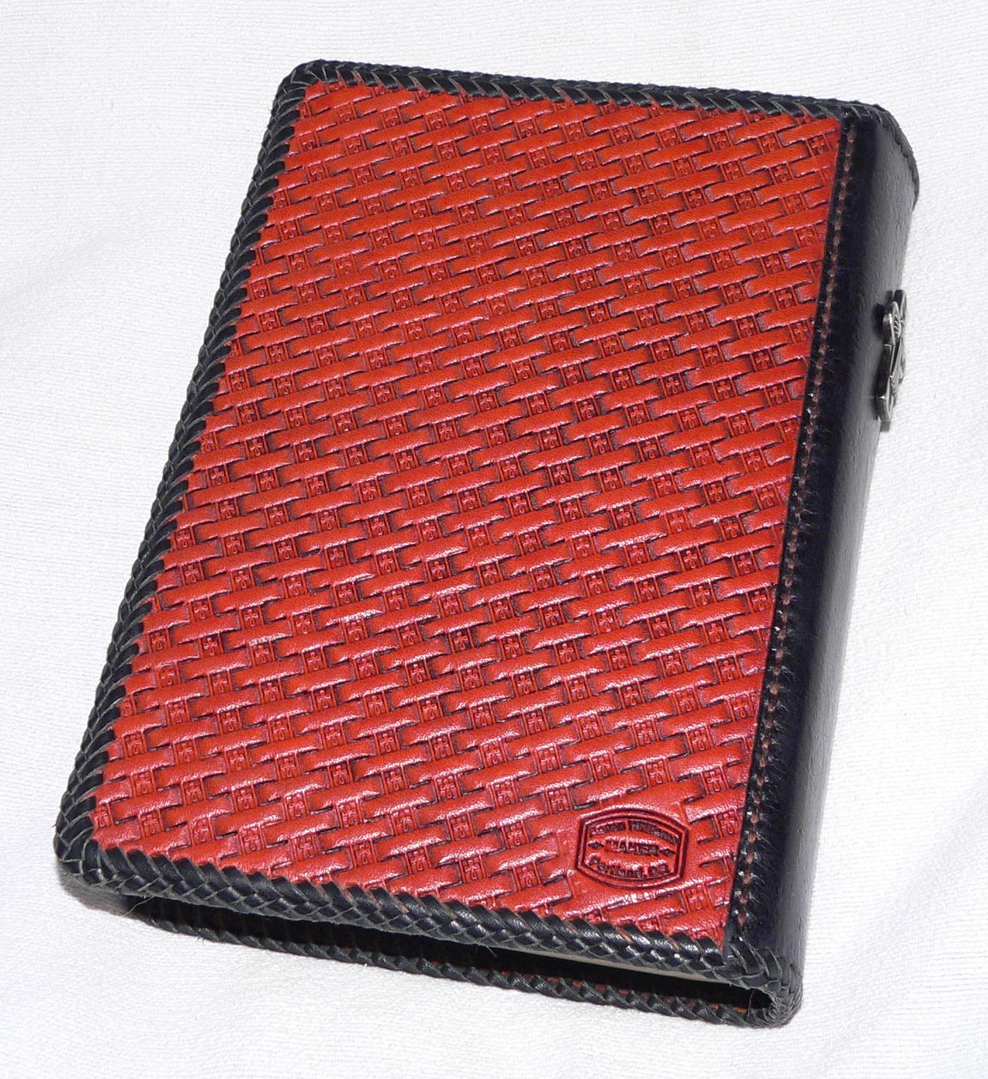

I have tried resist and antique dye a few times, always with the same disappointing results.....why is this happening? I realize the pics aren't that great - but the best I can do. I put the resist on, let it dry, then applied the antique dye on a cloth, then rubbed it on the leather. The result is an uneven application - you can tell where I first dabbed the dye, and it didn't spread evenly...what can I do different? It is really disappointing to try so hard to tool something, then ruin it with dye. ARGH!

It looks to me like you are being too conservative with both your finish and the antique. Not sure what brand of finish you used, that can make a big difference too.
What I do: I usually cover the piece with a generous coat of Neet-Laq. One coat is better than two. Make sure you have full coverage. I use sheepskin as a dauber. Let it dry overnight. I then cover it with a layer of Fiebings antique paste. It needs to be really covered. Right away wipe it back off. I wipe it on with sheepskin, wipe off with a rag, then gentle directional wiping with sheepskin to do the final clean up. Follow that with a coat of Tan-kote.

I will usually use Bee Natural RTC as a resist. I do one light coat, let dry over night, and then do a second coat. After that I put the antique paste on, but I put it on thick. I use a dabber. As soon as I have the piece covered in antique, I will start wiping it away with a damp rag. I keep wiping until it's even, and then go back over any place that seems like it didn't get enough, and wipe down again. Once it seems even, I let it dry over night, and then do a light coat of RTC, and a second coat when that dries.

It LOOKS like you didn't get a complete coverage with the neat-lac. When it comes to things like basketweaves you must use something like a skeepskin to really get the neat-lac into the cracks.Use a fairly good amount on a scrap, wipe it across the lid and immediately start rubbing it in from all directions- circular, up, down, all over. It can't sit too long as you thought. It must dry.
If it stuck in the cracks in some places and not in others then you didn't get enough paste on it to begin with.
YOUR situation looks like you may have gotten too much on it in places as it didn't take on most of the cracks.
Remember, all that you are trying to do with the resist is to lightly coat the surface leather and allow the paste to invade the crevices.
SO>>>>>>> wet, DON"T SOAK, the scrap and scrape it across the lid and quickly and lightly cover the piece, let dry and proceed with the antique. GET HEAVY with the antique paste and REALLY RUB IT IN in all directions. I use a huge glob on my projects so that you can't see the leather while i smear it on! Wipes right off.

I use the Antique gel as well. I use sheep wool to apply it. you said you are using a cloth to apply yours and that might be part of the problem. The rag wont get the antique deep in to the tooling and that is the very reason a cloth is used to wipe OFF the antique because it wont go into the tooling and remove the antique. I cut off a small piece of sheep wool maybe 2x2" and trim it down so it's not so wooly maybe 3/8" long hair. apply the Antique to the wool and rub it in all directions. Keep applying the antique until everything is coated well. Then use a cloth to wipe it off. You need to keep the cloth from going to deep into the tooling so sometimes it helps to wrap it around something firm I use a dry sponge. Wipe off all the excess (change the cloth so it's always a clean) you may need to slightly dampen the cloth to get the last bit of antique off the surface. Of course this is all after I have done my resist. I don't use neet-lac I use leather balm with atom wax but I have used super sheen in the past and works as well. For the resist I apply a few good coats and let it dry then rub it with a clean sheep wool. apply the antique as above and then let the antique left in the tooling dry overnight. to finish I airbrush my finish on so it doesn't wipe any antique out.

It appears from your pictures, you are not applying enough antique paste. If you have spots that didn't darken, you weren't applying enough paste. Question, are you using Fiebing's Antique paste, or one of the Eco products? I found out the hard way, Neatlac and Eco products do not mix? Other question, are you using the wipe-on Neatlac (Clearlac) or are you trying to use the spray version? I apply two light coats of the Neatlac (wipe on), and let dry overnight. Then I apply the Fiebing's Antique Paste with a piece of sheep wool, and goop it all over, really goop. I then use sheep wool to get the excess off as you really want only to leave the paste that is in cuts, background areas, etc. If you don't, you will end up with with "dryed mud puddle areas" on your work. There is an excellent vide on antiquing on U Tube produced by a saddle shop (can't remeber the name). Hope this helps,

After looking at your project it appears to me that you didn't get nearly enough NeatLac on as a resist, nor does it appear that you applied enough antique paste. IMHO NeatLac is best applied with a trimmed piece of woolskin. I apply it thoroughly and sometimes twice to insure that I get a good even coat covering ALL of the leather. When it is completely dry I apply my antique paste with a trimmed woolskin and rub it in thoroughly insuring that every little crevice is coated. I then remove the bulk of the paste with a few paper towels. This does two things for me. One, I don't waste woolskin and two by wiping the residue off with a paper towel, residue is left in the cuts and background. Depending on how dark I want the cuts to be I then scrub the entire surface with trimmed woolskin to remove the balance of the residue. Typically I try to remove everything from the cuts and background because they are already darker by virtue of being left exposed to the antique longer than the smooth surface of the leather. I then polish the surface of the entire piece with trimmed woolskin. At this point no residual antique is picked up with the woolskin and the surface of the leather takes on a nice glow. I prefer to use NeatLac as a final finish. While using Tan Kote is fairly common....Tan Kote is is what is used to "cut" antique paste, so it never made sense to me to use it as a finish when antique has been applied. One additional tip I might offer. Before applying a resist, I clean my leather with Oxalic acid. This helps to insure that any reisdual dirt, oil etc., is removed from the leather. It insures that your color will come out smooth and even rather than blotched. After, all, that is the purpose for applying a resist in the first place.....to create a smooth even finish on a product which has a natural inconsistent surface which is further varied by handling, tooling, etc.
