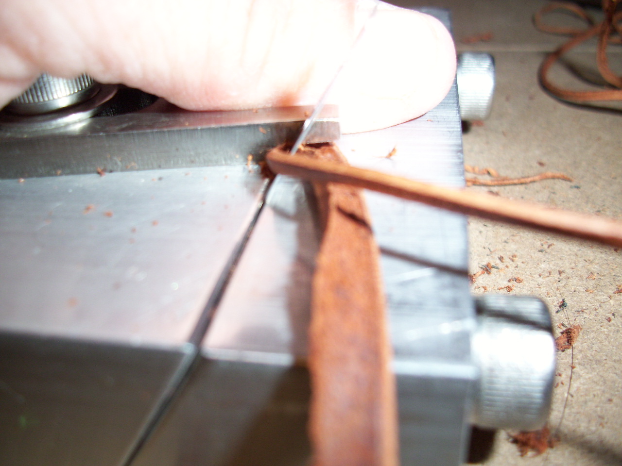

post-16420-045074200 1305578690_thumb.jpWell how is it looking so far?? First cut done on all 3 hides cut at 3/8 inch.
Is those scrap pieces used for anything?? Do ya continue to cut lace all the way to the middle. As you can see I stopped once it was getting to be pretty tight,
Will stretch then do the hard part. I'll try and take pic's of how I got the cutter and beveler set up so that if someone sees me doing it wrong will be able to give me some tips. Expecially with the bevel, for some reason the lace wants to fold up even with me pushing down on it to try and keep it from folding up. But maybe with me starting out with wider lace that might help. We will see. Just wanted to post pic's of what I have so far to show how the process is going.
Thankspost-16420-085747900 1305578646_thumb.jppost-16420-021300300 1305578719_thumb.jp

Well so far, all appears to be going just as it should with the rough cutting.

you can get a bunch more smaller lace outta those pieces....looks pretty good...i think you have been psyching yourself out...and just needed to get started!
Annette
Gday Annette
I have taken 5minutes or so of video tonight about setting the beveler up for beveling and will try and post it on youtube tomorrow night , if all goes well I will sent you and Joe a link
When I rough cut my lace I normally end up with a piece about the size of a bike seat left over , when the turns get a bit tight , i just cut the tight curve out to make it abit smoother to go around , then with the bike seat size left over I use a Tandy lacemaker and get a heap more lace that has very littlle stretch in it because it is in the middle of the roos back
Sorry you are having a hard time with the beveling side of the cutter , hopefully this video will help you sort it out
Cheers
Bevan
www.wbrwhips.com
Edited by Bevan
Bevan. I do the same thing as you do with my left over piece. I thought at one time that it would a crazy thing to do. But seeing you do the same thing with yours, I am now a bit more relaxed about it. Thanks for that post.
