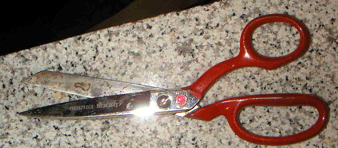

Members gesa Posted July 20, 2011 Members Report Posted July 20, 2011 Hello Ray, how do you sharpen your other tools? Do you use a machine or do you use a stone? If you use a stone, I have no advise because I am spoiled at work with this maschine: I can sharpen every type of knife and scissors with it. For scissors besides the edge there is always important that the blade is polished, because any kind of residue like glue , dye or rust will prevent that the blade can cut. Be very careful that the blade remain strait, do not polish the blade edge from that side! This one need polishing: To sharpen the blade is not more difficult than a knife, the only difference I make is that I don't polish it. I only use the sanding belt. This is because I usually sharpen leather scissors, if they are polished the leather slips sometimes. Gesa Quote
