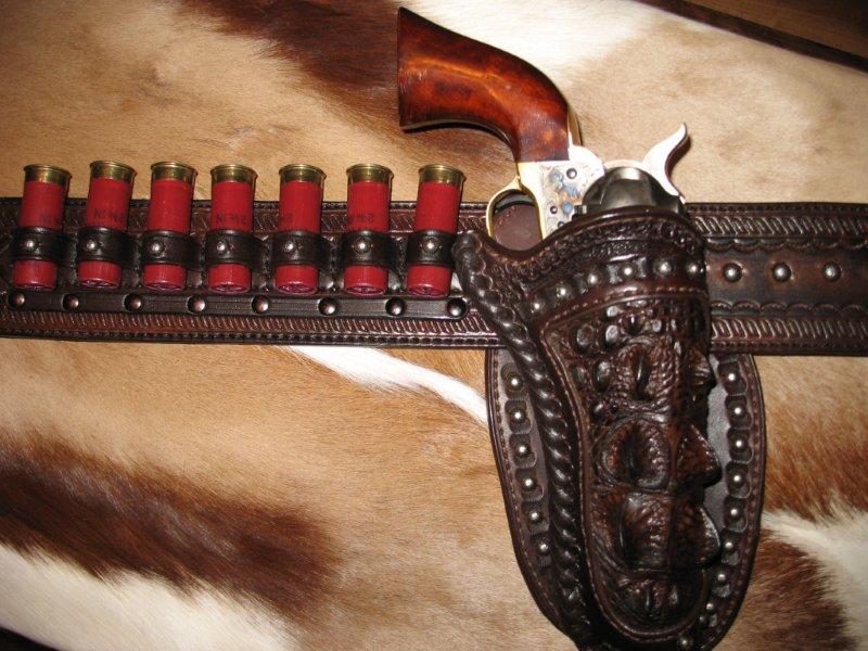

Members kid terico Posted July 21, 2011 Members Report Posted July 21, 2011 Dave does outstanding inlays of all types. Here are 2 of my croc inlay rigs to give you some idea. One holster only and other holster and belt. KT Quote

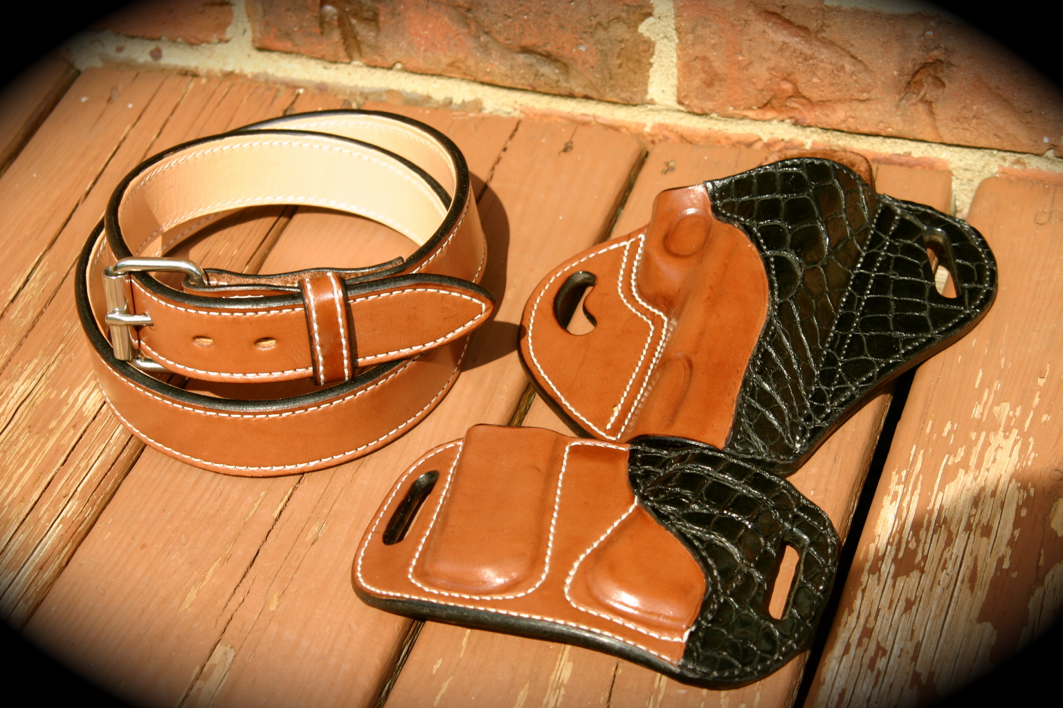

Members mmirob Posted July 22, 2011 Members Report Posted July 22, 2011 You guys are simply amazing... I must try an inlay. This is what I have been doing but this technique looks so cool! Quote
Members Shooter McGavin Posted July 22, 2011 Author Members Report Posted July 22, 2011 mmirob: yep, thats the style I typically do as well. I guess we can call it an "overlay"? Is that beavertail? Also, that belt is sharp as all getout. I agree. The stuff these guys posted in here is amazing! Simply amazing. Quote Zlogonje Gunleathers
