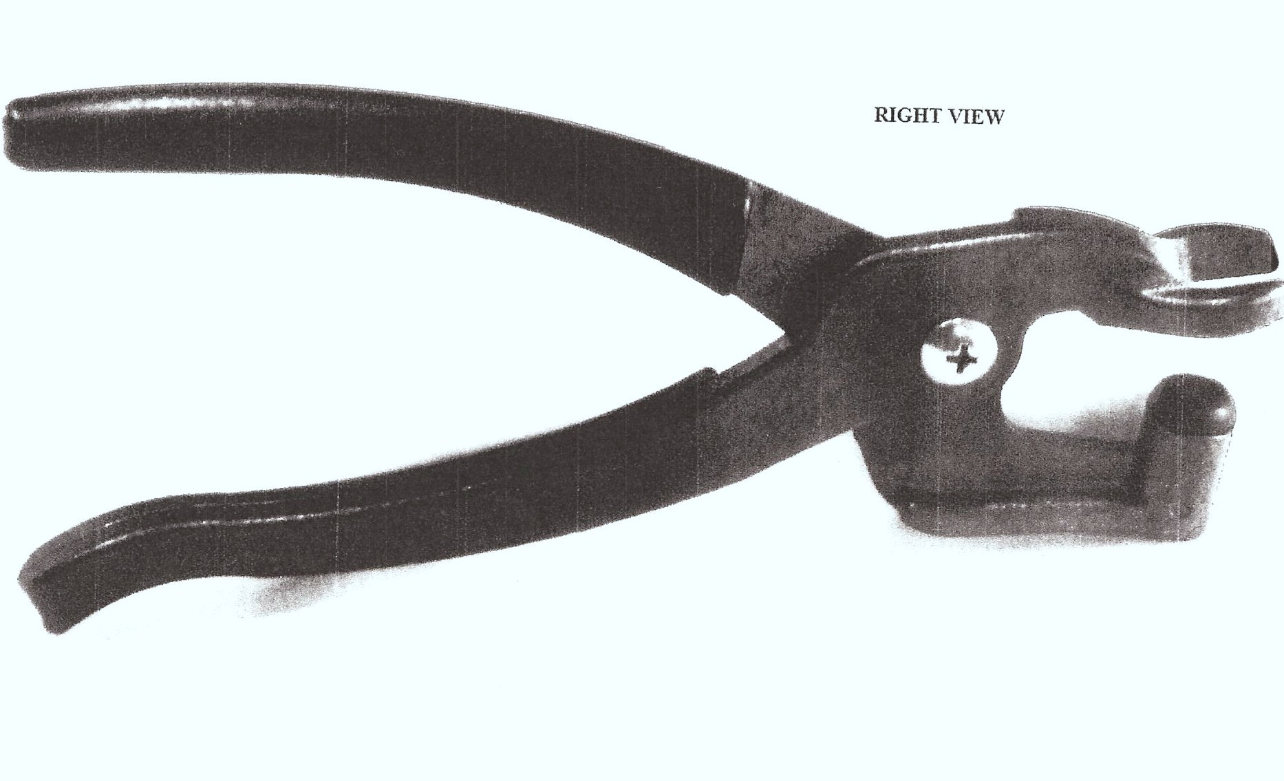

Members equinetacktool Posted January 15, 2008 Members Report Posted January 15, 2008 I have designed a new tool for holding chicago screws. My website is jpequinetacktool.vpweb.com JP'S Equine Tack Tool
Ambassador pete Posted January 15, 2008 Ambassador Report Posted January 15, 2008 Nice tool but I'm not sure that I get it. What's the matter with a screwdriver in one hand and a piece of rubber innertube in the other( and maybe some lock-tite for the threads if I get paranoid)?

GMorris Posted January 15, 2008 Report Posted January 15, 2008 These are a great little tool, I have sold several on ebay. check with B.Johnson on this sight, I think he will give some feedback. Nothing is wrong with the old way of removing/ replacing chicago screws or conchas, but nothing was wrong with farming with mules and oxen before the tractor came along either.
Moderator bruce johnson Posted January 15, 2008 Moderator Report Posted January 15, 2008 Pete, About the piece of inner tube in one hand and the screwdriver in the other. Issue I had was once the force was applied to the screwdriver, and it happened to slip off those shallow worn screw slots, the blade will penetrate some distance into that hand holding the piece of inner tube. I am a slower learner, and have done this a few times. I have had some luck with a piece of inner tube on top of the bench and using that as a backing. It works a little better. If I don't care much about the concho, a vicegrip on the head and a little heat from a soldering iron on the screw can loosen them too. This little tool has a rubber head on one side, and a "forked" jaw on the other to surround the screw head. When you grip it, the rubber hold the post or concho, and the forked part relieves some of the bind on the screw head. When I first saw this thing adverised in ShopTalk or wherever it was, I told my wife I ought to get one. Ended up and put it off, finally saw the ebay listing and bought two, one for me and one for a gift. I have one of my first headstalls, and my late first wife used one of our old Garcia bits on it, and put some old Visalia conchos on it. Her family was one of those nail polish or iodine (corrosive) on the screw threads to secure them bunch. For a few years, I have kind of been wanting to retire this headgear, but wanted the bit on another headstall. The bit end conchos won't budge with anything I tried without risk. I got this tool, got a grip and gave a twist. First one backed right out. Other side was a bit harder, and I slipped. Since my left hand was gripping the pliers, no bleeding. Second twist got it. Yeah, this tool works. With the value of the conchos and bloodshed it saved, I am money ahead. Bottom line though, I couldn't bring myself to change it out and put the bit back on with those conchos. My first concern when I got it was that it was made from some space age plastic, not metal. After using, it should be. There is just enough flex, you won't scissor action your way through most leather as you grip harder. I don't use it on every concho or Chicago screw, but it fit the bill when I needed it so far. I have used it more than I expected. Bruce Johnson Malachi 4:2 "the windshield's bigger than the mirror, somewhere west of Laramie" - Dave Stamey Vintage Refurbished And Selected New Leather Tools For Sale - www.brucejohnsonleather.com

Moderator Art Posted January 16, 2008 Moderator Report Posted January 16, 2008 I have one of these puppies. It is a good tool more for taking the screws out than putting them in although it works good for that also. Especially if someone put Loctite in one. Now, I use it on belts primarily. Whoever developed this must be a horseman as they only made the jaws one inch deep. No way to use this to get to the center of a 2.5 to 3" cartridge belt. If there was a version with 2 inch jaws I would buy that also. It also works great for installing and removing conchos with Chicago screw attachments, especially the small ones you can't seem to get tight enough not to spin. Art For heaven's sakes pilgrim, make yourself a strop!

Members Studio-N Posted March 6, 2008 Members Report Posted March 6, 2008 I have to agree with Gremlin, these really help holding things when the arthritis was bothering me. I've only had mine a week and I used it in the store to help a customer change out the concho in his cell phone case. The plier helped to push the concho post through the double layer of the flap and held it in place nicely while I tightend the screw. Quick and comfortable. peace. There is a nice rubber tip on the concho face side, so it doesn't mar the surface. peace. "Out of my mind.....back in 5 minutes"
