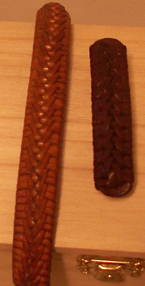

Tom, they are not "through" the leather strap base, just wrapped around it and then back up the center. You will see in the tutorial I am working on. I thought it looked a bit like Shirleyz, when you posted your case. I thought about doing a belt this way until I figured out how much lace it will be! Going to do a Hat band instead soon.
Clay, on the initial wrapping I do not do the "over, under" thing. so there is no center to go under. After it is wrapped it is just 3 up 2 back. You will see. Mine lays flatter against the wrapping than Rene's way of doing it. I made mine about a year before I took Rene's class. A friend named Jeff Leida in Tulsa OK showed me how to do it. He also made one with the smallest round lace you can get with done is double rows. As soon as I do one that way I will post it. I did take Rene's class on it to see how different he does his, plus how to make the leather stone.

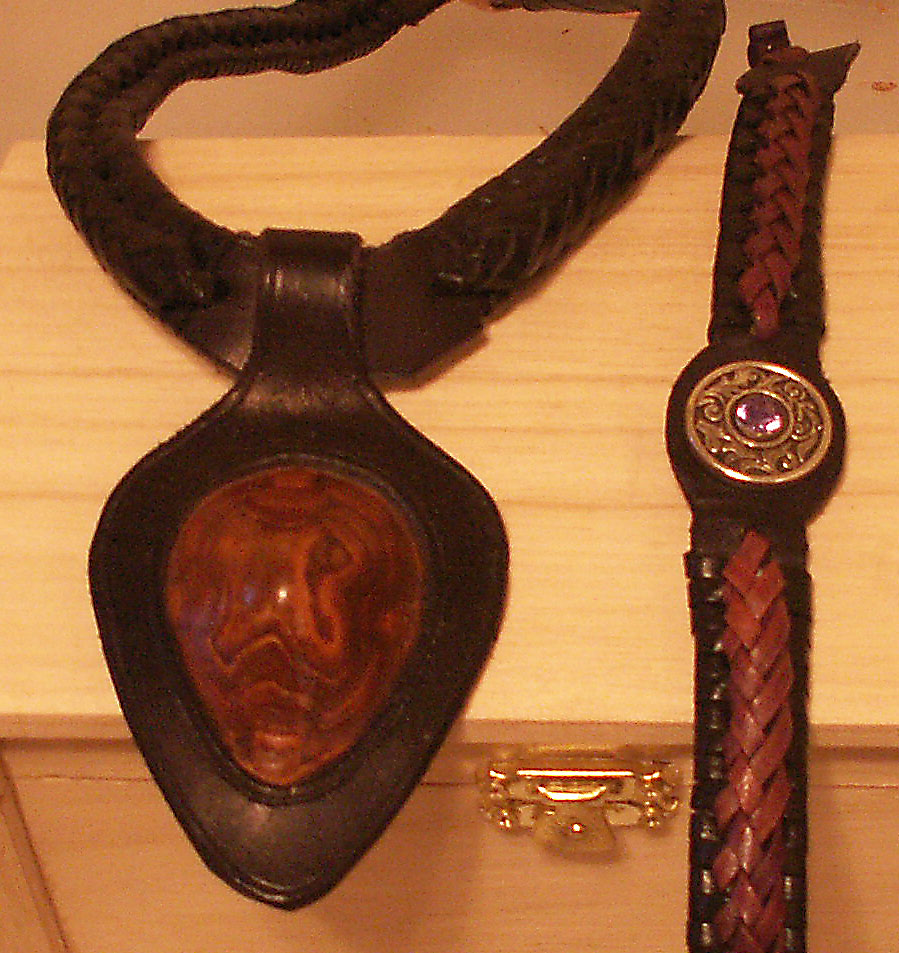

PICT0171_edited.JPGPICT0172_edited.JPGHope these are better pictures. One is the first braclet I made and then the barette. The other picture is the necklace I did in Rene's class and YES the stone is Leather too. the purple one is one that Clay made for me putting a concho in the middle.

Coat with Carnauba cream and massage in until all of it is absorbed. As you are rubbing it in start shaping into the shape of a bracelet.
