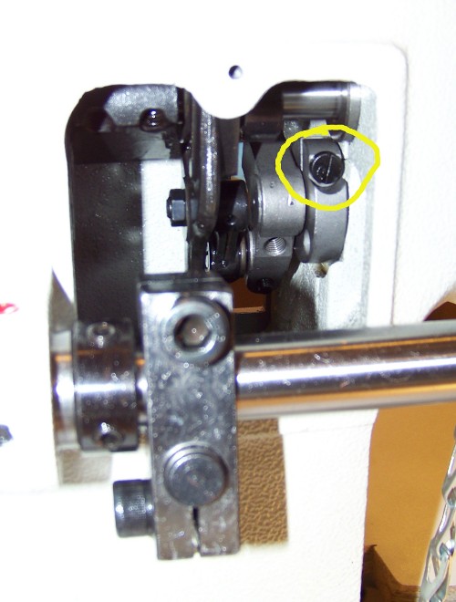

MADMAX22 Posted November 8, 2011 Report Posted November 8, 2011 Didnt catch this thread but I had a similar issue with mine. Sorry I dont know the names of stuff but on the opposite side of the machine from the stitch length adjustment lever (that you use for reverse) if you remove that cover there is a screw in there that on mine had started backing loose and thus was causing the stitch length in reverse to be longer then they were in forward and sometimes at odd lengths. I think Bob will know what I am talking about, I would have to look up the name of it but its pretty obviouse when you pull the cover off. Quote

Members Rayban Posted November 8, 2011 Members Report Posted November 8, 2011 Didnt catch this thread but I had a similar issue with mine. Sorry I dont know the names of stuff but on the opposite side of the machine from the stitch length adjustment lever (that you use for reverse) if you remove that cover there is a screw in there that on mine had started backing loose and thus was causing the stitch length in reverse to be longer then they were in forward and sometimes at odd lengths. I think Bob will know what I am talking about, I would have to look up the name of it but its pretty obviouse when you pull the cover off. I've never had that cover off...should I be oiling something in there?? Quote Raybanwww.rgleather.net
