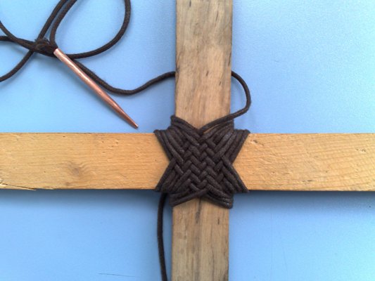

All righty, did anyone figure out how to do this. I thought I had it until I turned my cross around and I had like 5 wraps around the top and bottom of the cross and only one or 2 on each of the sides. Can't figure it out, about to have another go. You would think as many turks heads I've made I could figure out how to do this one, it's the same principle, it's just that I can't really figure out when to go over and when to go under and what string I'm following.
Ok. Here they are.
The thong comes from behind the long arm of the cross. It goes from the bottom to the left arm.
Then from the left to the top
Then it goes from the top to the right and when it comes back to the bottom, it goes over one under one.
That is the base of it. Now you just repeat the same sequence from bottom, to the the left, top and right but every time you find thongs, you cross them unver or over so they lock. This picture shows 1 complete turn through all the 4 arms. When it goes up, first it will go UNder 1 and Over 1. Then for the following, it will be Over 1, Under 1 and Over 1 untill the first complete turn is done.
One more complete turn.
And this is how it looks from behind.;
You can put something before hand in that space so it doesn't look empty. I have seen for example a piece of rawhide cut as a cross.
I hope this help.
Cheers,
Enrique

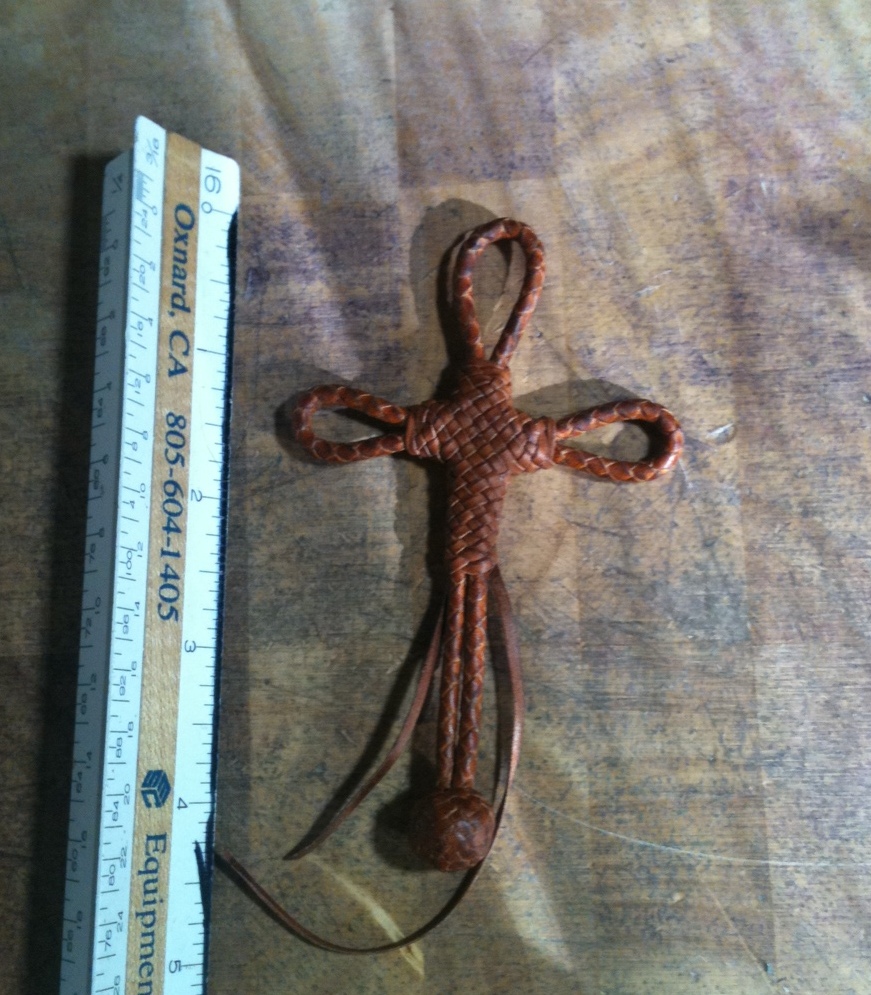

got it figured out. Took quite some time. The strings would end up in the wrong place when I did the wrap. Still not sure if I could do it again but at least when I do it wrong I know I'm just following the wrong string.
I wanted it to be a key chain but I don't think it's gonna work. It's roo of course, but I braided it over a strong fishing line so the cross would hold its shape. I'm not sure it's gonna work because the fishing line really wants to twist in ways I don't want it to, so I made this one a Christmas ornament. I tried other knots to hold it in place better but it didn't look very good.
The only thing is, how in the world do you hide and secure the strings on that turks head?

I told you I knew how to make one, but I haven't done anyone other than to show people how to do it. Probably I will hide the ends under the whole braided part on the front.

I ended up hiding the strings on the back side of the cross under the loops. I'm calling it a Christmas ornament so I should be OK.
