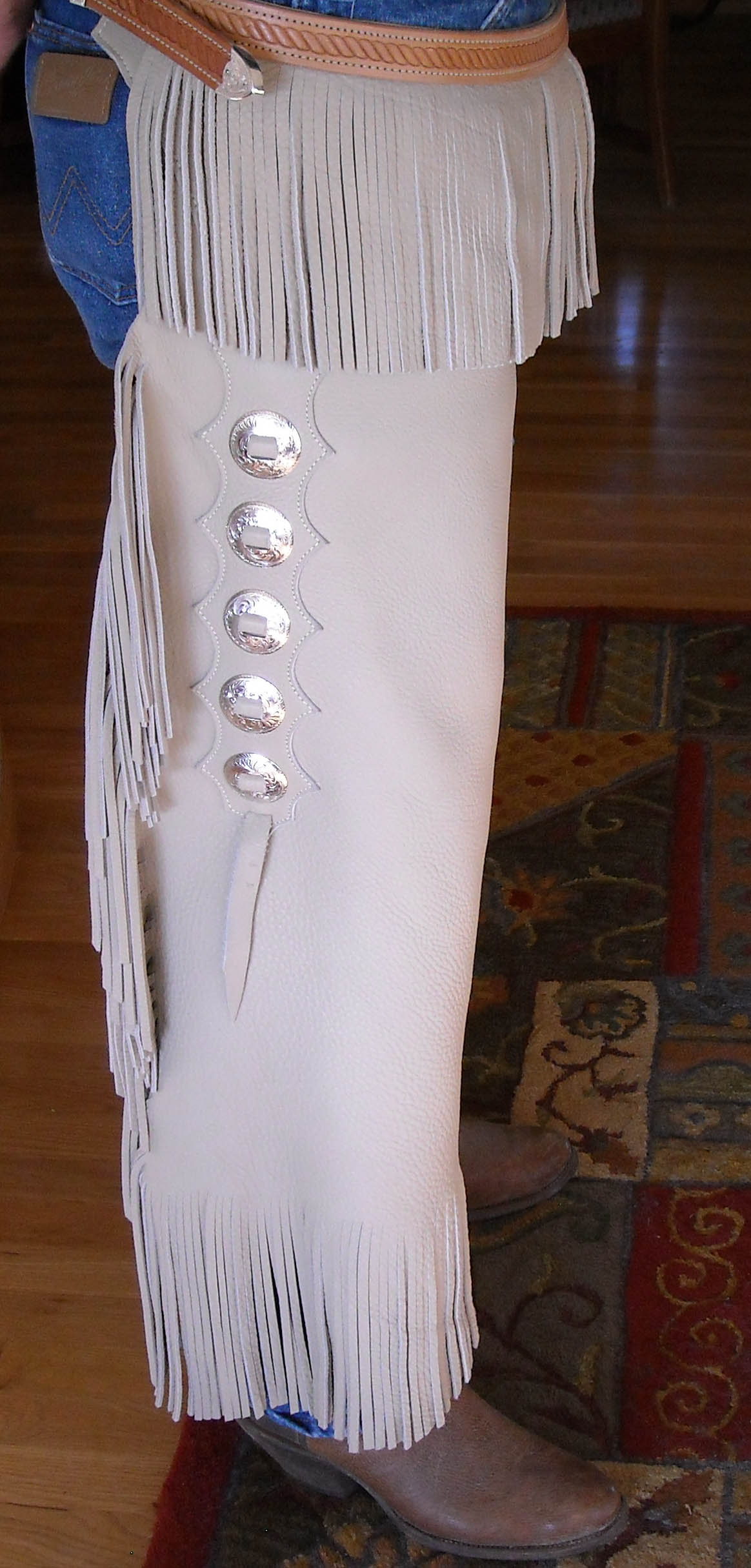

Members harrington Posted December 20, 2011 Members Report Posted December 20, 2011 Some new armitas I just delivered to some friends in Gypsum, CO. The grey ones have double fringe on the leg with black underneath, both have Montana silver buckles and conchos. Thanks for looking Quote
rickybobby Posted December 20, 2011 Report Posted December 20, 2011 (edited) Wow, Nice Job!! It was a good choice using the black contrast for fringe and thread on the grey pair. I have not mustered up the courage to contrast to many trim colors, I usually stay in the color range I am working with (like brown & light brown! lol !!) I am afraid I will end up with something that looks like the "Golden Arches" or worse, unintended Rodeo chaps !!! Both pair look excellent, the customers should be very pleased. Rick Edited December 20, 2011 by rickybobby Quote Rick

Members Aurelie Posted December 22, 2011 Members Report Posted December 22, 2011 i really like the look of them! NICE job! May i ask the technical difference btw "Armitas" and chinks? Quote In for a penny, in for a pound....
Members harrington Posted December 22, 2011 Author Members Report Posted December 22, 2011 True, traditional armitas have no hardware, using a wrap and tie belt with an apron front and laced legs that you step into like pants, or leather buttons. I make mine with a 1" sewn on belt to the apron front with a buckle in the back and either laced step-ins or a zipper leg connection. Chinks are usually open in the front with a buckle strap or light lace connector and tend to be a bit shorter and usually a rounder pattern than the square leg shape of armitas. Thanks for the compliments Quote
