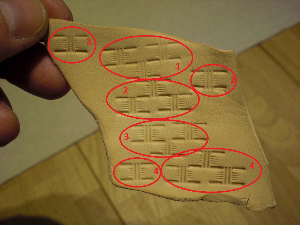

I took another leather scrap that I got from one of Holland's shop. It is much thinner than that Tandy's (I would say Tandy is about 8-9 oz to me, that one is about 4 oz).
Well, I have made some investigations, please look at the picture attached.
I damped piece very much (not soaked though) and made the impressions 1 right after damping (0 minutes from "zero" :) ) just by pressing tool by hand.
After 15 minutes leather looked pretty "wet" and I made impressions 2. Serie of imprints are done by pressing tool by hand and separate imprint number 2 is done with poly mallet strike.
I spent 15 minutes more by watching TV and then (30 minutes since "Zero") I made imprints n.3 in the same way - serie just pressing, separate by mallet. Leather was ALMOST ready for tooling but a bit darker yet.
20 minutes more (50 mnutes from "Zero") - leather went into "just as it has to be for tooliing" - almost original color and cool. I made imprints numbered as 4 in the same way as above.
Finally I took a hairdryer and dry this piece in 10 minutes.
So, what would be your sentense?
To me it sounds like Tandy's leather from the belt kit is sucks - it is hard to compress by tool while tooling and it is losing depressed shapes as it is going to be dry (perhaps of grain layer is going to shrink while drying).
I HOPE I\m wrong about that belt kit blank, so please give me your suggestions.

If you could tell the leather was too damp then the odds are that the leather was just too damp. Some leathers can take hours to reach the "quick case" stage.
You are not casing your leather coorrectly. Tandy leather has nothing to do with the problems you are having. Access the archives on this forum for casing lleather.
Thanks in advance!

So most likely it is casing...
Let me please clarify this.
That belt what faded was cased as per Bob's suggestions - damped, wait until "almost ready", packaged into garbage bag (may be I must kept it in there forever??? :) ), was sealed there overnight, then opened, wait a bit until ready and tooled.
The piece I showed of course was not cased properly as I just wanted to see if it is my stamping problem or wrong moisture case.
I just buffled a bit because impressions on the "cased like it should be done" (at least I hope it was "like it should be done":) ) leather look much worse (to me) than that brutally damped and partially just embossed offcut.

I did tooling using basket stamp (x511 for instance) and initially had pretty good impressions there with solid brown color - leather was a bit damp at that time.
If you properly cased the leather there is no chance it would have been "a bit damp". You check for coolness (evaporation still occurring) against your skin because you can no longer see visible moisture. That means it wouldn't appear damp. It returns to it's original color and all visible moisture is gone. It should appear dry. When you look at the leather it should not appear any different than it was before you wet it.
What you describe in your post is exactly what happens when you tool leather that has too much moisture still. You get an OK impression when you stamp it but when you let it sit the moisture relaxes the fibers and your stamping loses it's clarity and definition and the burnish fades.
Thanks alot for such a detailed explanation, it becomes clear to me now.
I just always afraid to have leather more dry than necessary, so as soon as "dry looked" spots appear on the surface I usually start tooling. So at that time there are some damp spots are still on the surface. That most likely is my mistake there.
