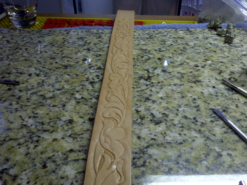

Members Reds Leather Posted January 4, 2012 Members Report Posted January 4, 2012 I have tried Eco-flo Antique gels and now Fiebings Alcohol based dye and nothing is coming out right. I like the way the Fiebings works but the "medium brown" came out Brown/Redish... more along the lines of Rosewood.... Whats the key? They are all being applied to veg tanned leather. Do i need to wet the leather first???? Mix a little water with the dye? And how long should i wait between coats? Until its dry? Or hours? Here is the pre dyed picture and two dyed pictures of the same belt. PLEASE HELP THIS IS DRIVING ME NUTS! Red Quote
Ambassador pete Posted January 4, 2012 Ambassador Report Posted January 4, 2012 personally I really like it as is. Use a coat of Bison brown as I think that you will get what you want more than say a dk. brown. pete Quote
Ambassador abn Posted January 4, 2012 Ambassador Report Posted January 4, 2012 I agree with Pete. Looks good as-is. However, if you're really after a medium brown, try one of the following two options (on scrap first, of course): (1) Mix Lexol with your Fiebings Medium Brown spirit dye. This will cut the absorption rate of the dye and lead to a lighter, richer color. (It will also properly condition the leather.) (2) Try Eco-Flo Leather Dye in the Timber Brown color. Apply in several very light coats until you get the color you're after. Good luck -- achieving a decent medium brown is a significant challenge for all leatherworkers! You're not alone in trying to figure this out. Quote
Members Treed Posted January 4, 2012 Members Report Posted January 4, 2012 I usually use walnut with a quick dip or cut with denatured alcohol. After drying I start to had light coats of oil with 24 hours of dry time between coats to reach the brown color that I want. Bobby R Quote Bobby Rose Rock'n R custom holsters
Members katsass Posted January 4, 2012 Members Report Posted January 4, 2012 (edited) I have tried Eco-flo Antique gels and now Fiebings Alcohol based dye and nothing is coming out right. I like the way the Fiebings works but the "medium brown" came out Brown/Redish... more along the lines of Rosewood.... Whats the key? They are all being applied to veg tanned leather. Do i need to wet the leather first???? Mix a little water with the dye? And how long should i wait between coats? Until its dry? Or hours? Here is the pre dyed picture and two dyed pictures of the same belt. PLEASE HELP THIS IS DRIVING ME NUTS! Red FWIW from the old grump; I use Fiebing's Pro oil dyes mostly, but also some of their spirit dyes. I start by diluting them 50/50 with denatured alcohol. I use the least expensive airbrush (quick change airbrush @ about $6.00) that Harbor Freight makes, along with their smallest airbrush compressor (total, with airbrush, of less than $70.00 with the omnipresent 20% coupon) to apply my dyes in a uniform manner. Fiebings Dark Brown and Med Brown dyes have some red in them as they come, so for a more 'true' brown I use either their Walnut or Chocolate browns. I wouldn't use any water on my leather prior to using a solvent based dye of any sort, but I do shoot a light shot of neatsfoot oil after the dye has dried. I shoot all parts prior to assembly, and since I make holsters primarily, and wet mold them, I have found that the use of any water based dyes is just not compatible with my construction techniques. Mike P.S. I wait about long enough to consume an adult beverage between coats of dye. Edited January 4, 2012 by katsass Quote NOTE TO SELF: Never try to hold a cat and an operating Dust buster at the same time!! At my age I find that I can live without sex..........but not without my glasses. Being old has an advantage.......nobody expects me to do anything in a hurry.

Members Sylvia Posted January 4, 2012 Members Report Posted January 4, 2012 I have tried Eco-flo Antique gels and now Fiebings Alcohol based dye and nothing is coming out right. I like the way the Fiebings works but the "medium brown" came out Brown/Redish... more along the lines of Rosewood.... Whats the key? They are all being applied to veg tanned leather. Do i need to wet the leather first???? Mix a little water with the dye? And how long should i wait between coats? Until its dry? Or hours? Here is the pre dyed picture and two dyed pictures of the same belt. PLEASE HELP THIS IS DRIVING ME NUTS! Red Ah yes, shades of browns... green browns, black browns, red/orange browns, and yellow browns. It can see where it would be frustrating when you are expecting a chocolate brown and get mahogany. For what it's worth I like this color. Fiebing's dark brown is a nice Dark Chocolate color. http://leatherworker.net/forum/index.php?app=core&module=attach§ion=attach&attach_rel_module=post&attach_id=55558 Quote A teacher pointed at me with a ruler and said "At the end of this ruler is an idiot." I got detention when I asked "Which end?"
Members Suicide Posted January 4, 2012 Members Report Posted January 4, 2012 PLEASE HELP THIS IS DRIVING ME NUTS! I had exactly the same issue with Fiebings Oil Dye on the belt I made. After dye dryes , I just put thin layer of neatsfoot oil on top of it and seem oil turned that redish tone into quite normal medium brown as I guess it supposed to be. That time I didn\t worry much about final belt color, so had a room for experiments Try it on scrap, hope it helps Quote My leatherwork gallery
Moderator Art Posted January 4, 2012 Moderator Report Posted January 4, 2012 On a busy weekend, we'd be a rockin' in the shop, at least to the point where we would all fall down. Last man standing make sure all the caps are on the containers. Art P.S. I wait about long enough to consume an adult beverage between coats of dye. Quote For heaven's sakes pilgrim, make yourself a strop!
