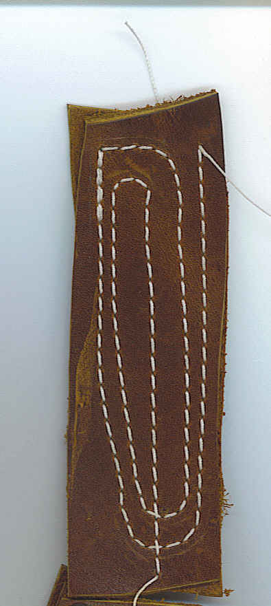

Tree Reaper Posted February 2, 2012 Report Posted February 2, 2012 Michael; I have a sample piece of 4/5 sewn with bonded nylon 66 size 138 using 794S DYX3 S needle and it looks good. Quote
mlapaglia Posted February 2, 2012 Author Report Posted February 2, 2012 Michael; I have a sample piece of 4/5 sewn with bonded nylon 66 size 138 using 794S DYX3 S needle and it looks good. Thank you! Michael Quote The key to immortality is first living a life worth remembering. Bruce Lee
