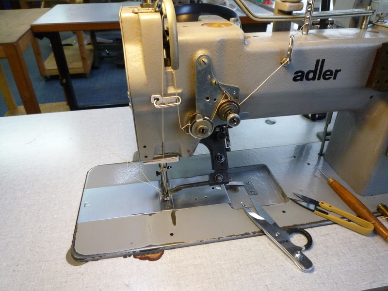

I think U guys are looking for this kind of sewing guide ! This guide swings up & is out of the way . I'm dreaming of the perfect sewing guide ! ! A sewing guide is almost more important than the machine itself ! ! !

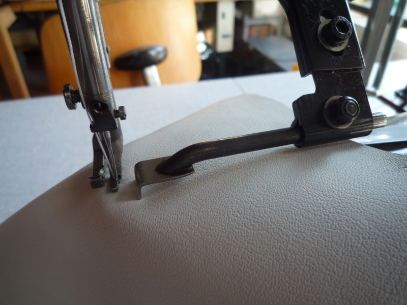

I have a drop down edge guide, similar to those used on Adler machines. It was custom fitted to my CB4500. It is fully adjustable for x, y and z axis'.

That's pretty much like the one Weaver Leather sells for their 441 clone.

Hello Andrew , Actually those guides exist for those big machines & once" you got one you'll wonder how you ever lived without one !
