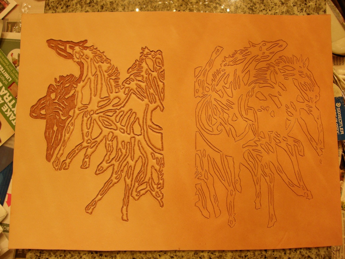

Contributing Member Bob Blea Posted February 6, 2012 Contributing Member Report Posted February 6, 2012 I'm working on a notepad for a friend. The artwork is based on a print from a wood block print his uncle made back in the 70's. It's a very stylized rendering of a herd of horses galloping towards the viewer. It's something he's always liked and when he showed it to me I felt it could be rendered as a inverted carving. The picture is only carved with the swivel knife at this point, but I liked how well it turned out I just had to share. This is easily the most detailed swivel knife work I've done to date, and it took two hours to carve the whole thing. Next I'll bevel the interior parts before bar grounding the whole thing. I know from a practice run that it will probably take me twice as long to bevel as it did to carve, but I'm not a fast beveler by any means. Below are the original print and the carved leather. The leather measures roughly 9"x13" Thanks for looking. Bob Quote There are always possibilities.... Bob Blea C and B Leathercrafts Fort Collins, CO Visit my shop at http://www.etsy.com/shop/CandBLeather?ref=si_shop Instagram @bobbleacandbleather
Members Rohn Posted February 7, 2012 Members Report Posted February 7, 2012 Looks like you did a great job with the swivel knife. Now you have your work cut out for you as you finish the piece. I am sure it will be a beautiful piece when you are done. I am anxious to see the finished masterpiece. Quote Rohn(John 8:32) And ye shall know the truth, and the truth shall make you free. (KJV)
Contributing Member Bob Blea Posted February 7, 2012 Author Contributing Member Report Posted February 7, 2012 Looks like you did a great job with the swivel knife. Now you have your work cut out for you as you finish the piece. I am sure it will be a beautiful piece when you are done. I am anxious to see the finished masterpiece. Thanks for the compliment Rohn, I started beveling tonight. It's great beveling practice and it takes a lot of patience. I'll post a picture once I have the bar grounding done. Bob Quote There are always possibilities.... Bob Blea C and B Leathercrafts Fort Collins, CO Visit my shop at http://www.etsy.com/shop/CandBLeather?ref=si_shop Instagram @bobbleacandbleather

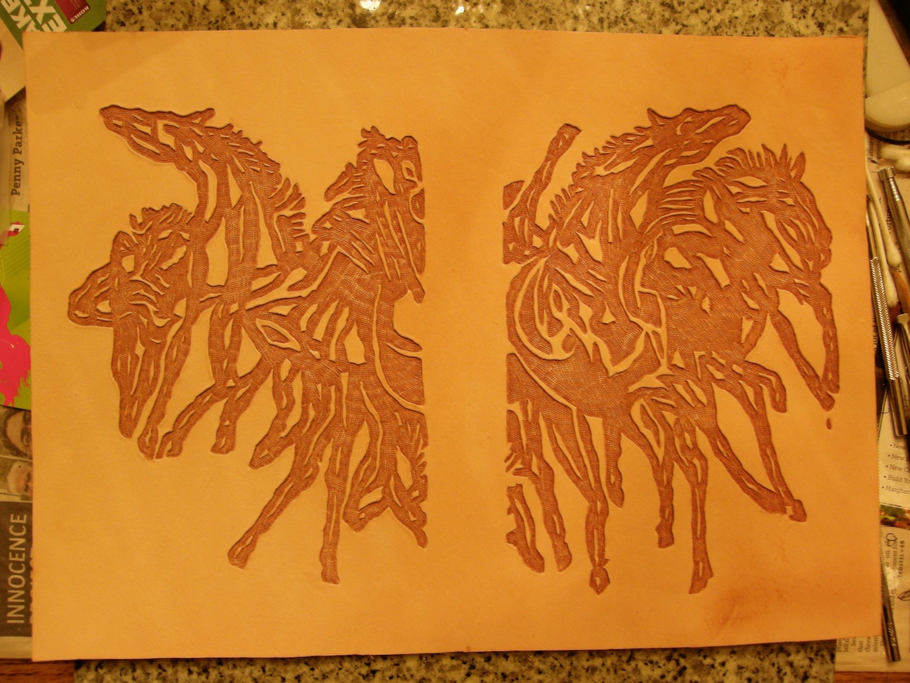

Contributing Member Bob Blea Posted February 10, 2012 Author Contributing Member Report Posted February 10, 2012 Here's the work in progress. The left side is beveled and the bargrounding has started. Usually my beveling is better than this, but in this case I am using the smallest beveler I have and I'm not trying to make a smooth edge. I'm trying to duplicate the very irregular edge of the original print, and marks left by the beveler will be covered by the bar grounder anyway. Thanks, Bob Quote There are always possibilities.... Bob Blea C and B Leathercrafts Fort Collins, CO Visit my shop at http://www.etsy.com/shop/CandBLeather?ref=si_shop Instagram @bobbleacandbleather

Contributing Member Bob Blea Posted February 14, 2012 Author Contributing Member Report Posted February 14, 2012 So, the carving part is done, and I'm pretty happy with how it turned out. Next it will be dyed. The customer wants it all black. Personally I would antique this and have more contrast between the carving and the untooled leather surface, but he has a specific look in mind and wants it all black. We tried a small sample and you actually do still see the carving pretty well, so I'm not trying to talk him out of it. Still, I like it better like this. Thanks, Bob Quote There are always possibilities.... Bob Blea C and B Leathercrafts Fort Collins, CO Visit my shop at http://www.etsy.com/shop/CandBLeather?ref=si_shop Instagram @bobbleacandbleather

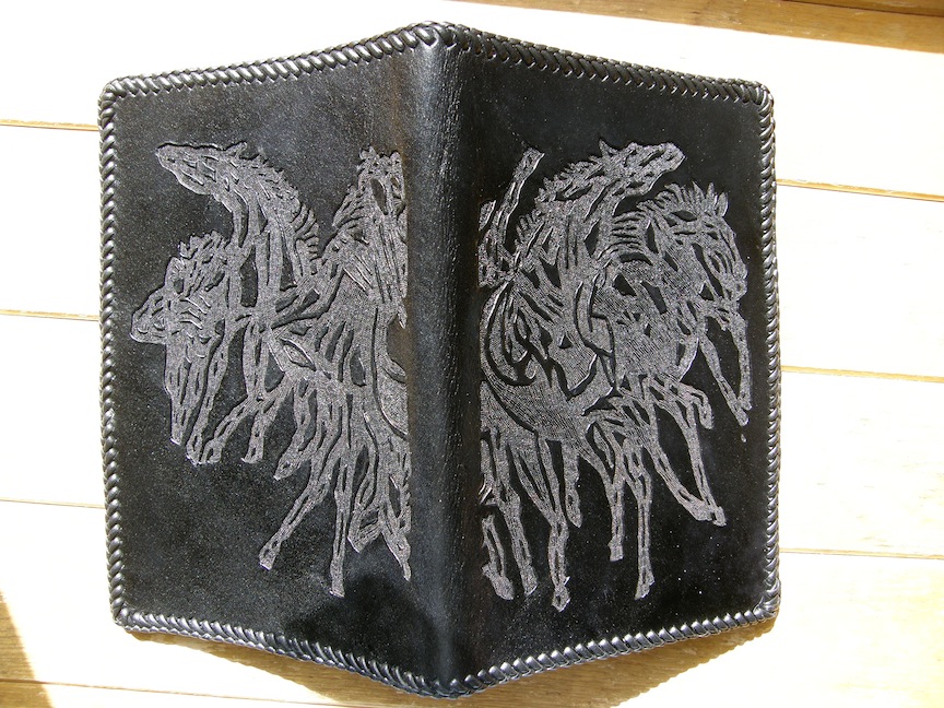

Contributing Member Bob Blea Posted March 11, 2012 Author Contributing Member Report Posted March 11, 2012 Well, I finished this up last week and delivered it to the customer, and he was thrilled. Here is the front cover. It was all dyed black with Feibings USMC Black. The bar grounded areas only look lighter than the rest of it because of how the sunlight is reflecting off them. The dark area at the bottom is actually a shadow that I didn't notice in the picture until downloading onto the computer. Thanks for taking a look and let me know what you think. Bob Quote There are always possibilities.... Bob Blea C and B Leathercrafts Fort Collins, CO Visit my shop at http://www.etsy.com/shop/CandBLeather?ref=si_shop Instagram @bobbleacandbleather
Members WinterBear Posted March 11, 2012 Members Report Posted March 11, 2012 That turned out really nice. I have to ask though-- How did you keep from going bonkers while doing this? Intricate doesn't begin to describe it. Quote I used to be an Eagle, a good ol' Eagle too...
Contributing Member Bob Blea Posted March 12, 2012 Author Contributing Member Report Posted March 12, 2012 That turned out really nice. I have to ask though-- How did you keep from going bonkers while doing this? Intricate doesn't begin to describe it. Thank you WinterBear. It did take a while to carve and bevel it. I just looked at it all as really good practice. When I look at some of the finger carving work I see here and how clean it looks. it didn't seem very intricate. Bob Quote There are always possibilities.... Bob Blea C and B Leathercrafts Fort Collins, CO Visit my shop at http://www.etsy.com/shop/CandBLeather?ref=si_shop Instagram @bobbleacandbleather
