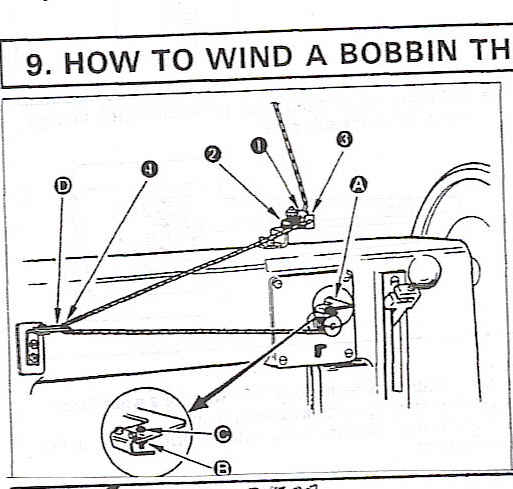

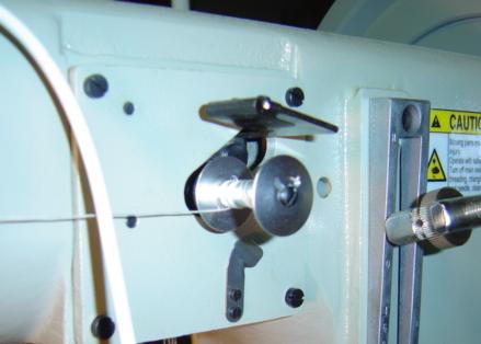

Tree Reaper Posted March 5, 2012 Author Report Posted March 5, 2012 (edited) I'm at the point where you wind the bobbin a few turns, is that clockwise or counter clockwise? The illustration shows the thread coming off the bottom of the spindle on the bobbin, is this correct? Wind it a few times then put the end through the hole in the bobbin? This is where I'm at now, does this look correct? Does the sewing machine need to be running, I think it does but do you disengage something to keep the needle from going up and down? My only complaint is with the instructions, the machine is operating better than the operator. Bobs video on threading the machine is great and I was hoping there was one on winding the bobbin. Edited March 5, 2012 by Tree Reaper Quote
KAYAK45 Posted March 5, 2012 Report Posted March 5, 2012 OK! hahaha!, I had the same concern. Don't worry, it spins in the right direction. You cannot do it wrong. Put the thread through the hole, hold it "gently" while starting, and just wind. The direction is not important at all. The only time the direction is important is when you put the bobbin into the holder. Maker sure it's to the RIGHT. Also be sure to put the bobbin holder back into the closed position before winding, and change your speed setting to HIGH for the winder to work properly. THEN make sure to change your speed setting to SLOW, after you wind the bobbin. Takes awhile to get the routine down. Easy after that! Those are the OPERATOR ERRORS I made. Kevin Quote Once believed in GOD and the DOllAR...... Hello God!

dirtclod Posted March 5, 2012 Report Posted March 5, 2012 (edited) The way you it in the picture is right just push the lever down. Wind it counter clockwise. When i have a empty bobbin i fill it while i'm sewing something else. It will stop on it's on when full.You can leave up there till you need it. Edited March 5, 2012 by dirtclod Quote I'm old enough to know that i don't know everything.

Tree Reaper Posted March 6, 2012 Author Report Posted March 6, 2012 Ron, that's excellent. Thanks for that. I missed running the thread around the wheel and that's probably where I lost some tension causing the birds nests. I find the written instructions very brief and vague for someone that has never operated a machine before. Quote
