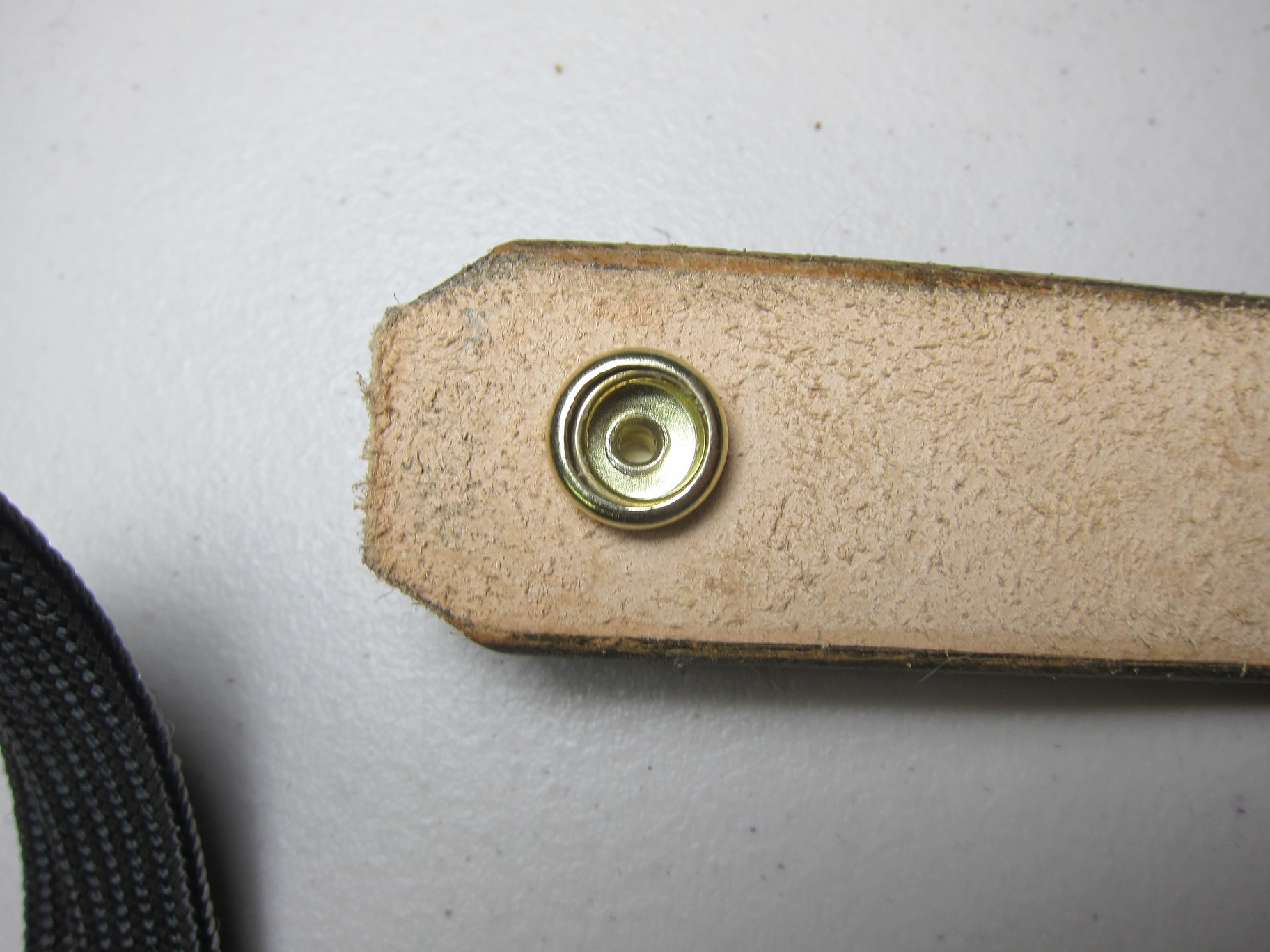

Mike516 Posted March 27, 2012 Report Posted March 27, 2012 I'm having issues setting snaps with the setter and anvil on bracelets. I'm using line 20 snaps on 6-7 ounce leather, which should be the right size. I watched GH's video on the proper way to do it because I thought maybe I was just doing it worng, but I'd say about 25% of the snaps pop off after only a few days of use. It's getting frustrating and I'm not sure what I'm doing wrong. Any tips or advice would be much appreciated. Thanks. Quote
Phatdaddy Posted March 27, 2012 Report Posted March 27, 2012 Any tips or advice would be much appreciated. Thanks. Can you take a pic or 2 of a snap that you have set? Looking down in where the flare from the setter and one side on showing any offset from top to bottom? Kevin Quote
Mike516 Posted March 27, 2012 Author Report Posted March 27, 2012 Now that you mention it, pic #2 does look a little offset. Would that be the issue? Quote

Ambassador Luke Hatley Posted March 27, 2012 Ambassador Report Posted March 27, 2012 Remember this....Only about 1/16 of the post should be showing...Anymore it will always bend over and make a crooked set... Quote Luke
