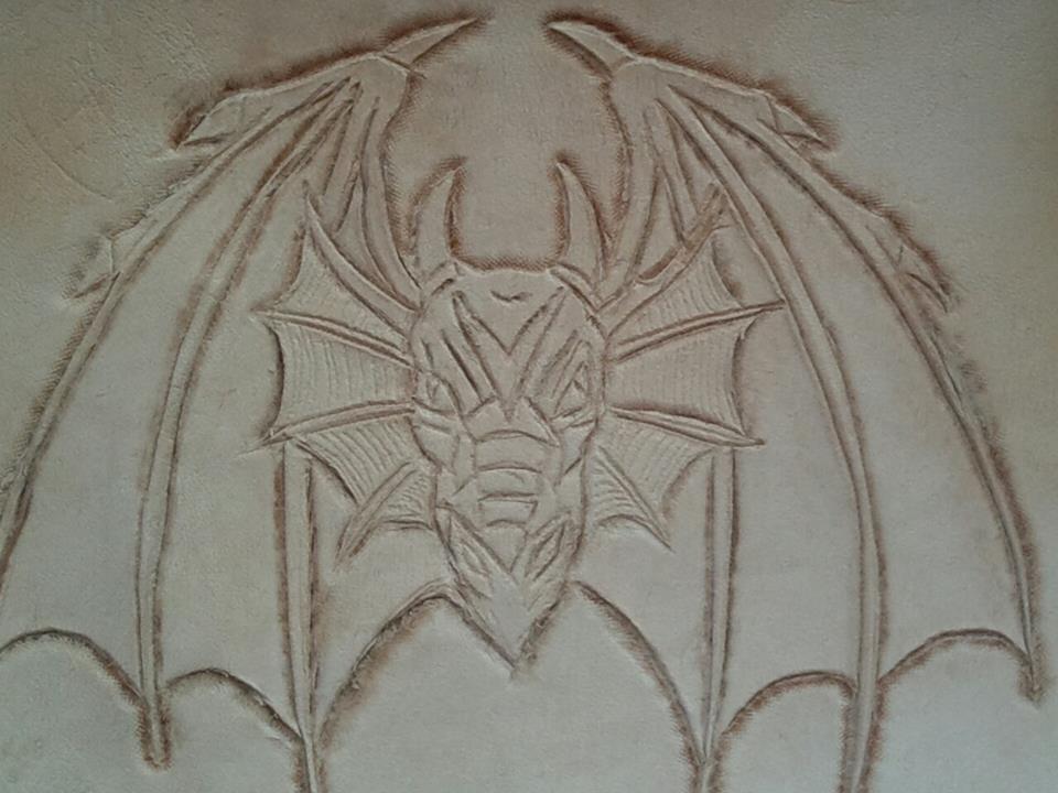

Members kndust Posted May 11, 2012 Members Report Posted May 11, 2012 (edited) [Here is my piece Edited May 11, 2012 by kndust
Members Sylvia Posted May 11, 2012 Members Report Posted May 11, 2012 On 5/11/2012 at 9:47 PM, kndust said: [Here is my piece Good job! You might want to try smoothing out those beveler marks with your modeling spoon. Overall I think you did awesome for your first challenge. Bravo! S
Members Cyberthrasher Posted May 11, 2012 Members Report Posted May 11, 2012 On 5/11/2012 at 9:47 PM, kndust said: Here is my piece What tools did you use on it?
Members kndust Posted May 11, 2012 Members Report Posted May 11, 2012 sorry I forgot to list tools I used swivel knife, beveler and modeling tool On 5/11/2012 at 10:02 PM, Cyberthrasher said: What tools did you use on it? I will thanks for the input On 5/11/2012 at 9:57 PM, Sylvia said: Good job! You might want to try smoothing out those beveler marks with your modeling spoon. Overall I think you did awesome for your first challenge. Bravo! S
Members Cyberthrasher Posted May 11, 2012 Members Report Posted May 11, 2012 it's still great, so I really don't want to take away from the job you did by giving more advice , but I have to since that's how we all get better and succeed. It looks like you may also need to work on your casing, and probably sharpen up the knife quite a bit. Beveling takes A LOT of practice to really get it clean looking. I struggled with it for a really long time. If your knife is anything like my beginner one was/is, all it's doing is compressing the leather and not actually cutting it. Mine came with a completely rounded edge and I used it like that for a little while stupidly thinking that that's how it was supposed to be because there's no way they'd send a knife that was supposed to be sharpened with a visibly round edge on it.
Members kndust Posted May 11, 2012 Members Report Posted May 11, 2012 On 5/11/2012 at 10:34 PM, Cyberthrasher said: it's still great, so I really don't want to take away from the job you did by giving more advice , but I have to since that's how we all get better and succeed. It looks like you may also need to work on your casing, and probably sharpen up the knife quite a bit. Beveling takes A LOT of practice to really get it clean looking. I struggled with it for a really long time. If your knife is anything like my beginner one was/is, all it's doing is compressing the leather and not actually cutting it. Mine came with a completely rounded edge and I used it like that for a little while stupidly thinking that that's how it was supposed to be because there's no way they'd send a knife that was supposed to be sharpened with a visibly round edge on it. again thank you for the info I just got back into doing leather since haveing a stroke back in 01 so I need all the help I can get right now
Members Cyberthrasher Posted May 11, 2012 Members Report Posted May 11, 2012 On 5/11/2012 at 11:22 PM, kndust said: again thank you for the info I just got back into doing leather since haveing a stroke back in 01 so I need all the help I can get right now Well, we're glad to have you back I just started this year myself, so all those struggles are pretty fresh in my head (ok, they still exist).
Members chancey77 Posted May 11, 2012 Author Members Report Posted May 11, 2012 It looks like a piece of 4-5oz leather which is very thin, so you can't really get to deep with the knife. It juts looks to me that the beveling and spoon smashed the knife marks. I know very well cause that is what I ended up using for the door panels, but the trick with leather that thin is not to do to much other than the cuts and a light bevel. Thanks for participating! I am way to swamped this month to do this challenge but I will enjoy the back seat:) LOL
