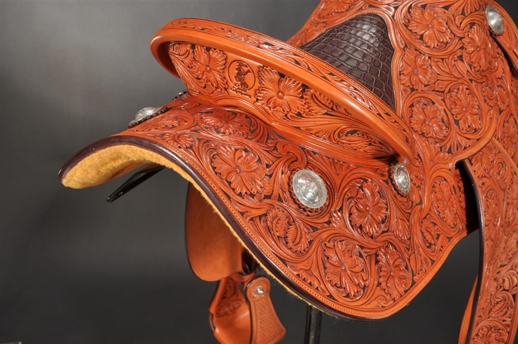

I haven't posted here in some time, and many of you have asked to see pics of this saddle.
I named this saddle"Ranahan". It is a full mother hubbard style saddle where the entire top of the saddle is molded from a single piece of leather without any splits or seams. I combined the swell cover, seat, riggings, skirts, and jockeys into a single piece. The inlaid seat is alligator. (I wanted tiles graduating from small to large, and the only part of the skin that does that is the throat. This is the throat cut from a 12 foot gator.) Keeping with the one piece theme, the fenders and stirrup leathers are made from one piece of leather, without the traditional buckles. Adjustment is at the top of the fender. Stirrups are specially shaped to complement this saddle. Final weight of this saddle is 26 pounds. Many hours went into this saddle both in its design as well as construction. It is a culmination of a lifetime of development.
It has been shown at the Cody High Style show; Wichita Falls, TX Saddlemaker show where it won Best tooling, Best workmanship, and Best of Show: National Finals Rodeo in Las Vegas; High Noon western americana show in Mesa AZ; and Trappings of the American West in Alpine, TX.
