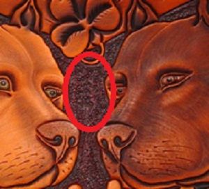

ivarian Report post Posted May 14, 2012 Hy mates I've a question? Which tool has been used for this Quote Share this post Link to post Share on other sites
pete Report post Posted May 14, 2012 Hy mates I've a question? Which tool has been used for this Tandy "pebble" background tool. pete Quote Share this post Link to post Share on other sites
ivarian Report post Posted May 14, 2012 Tandy "pebble" background tool. pete Tank's Pete:thumbsup: Quote Share this post Link to post Share on other sites
Spinner Report post Posted May 14, 2012 Hy mates I've a question? Which tool has been used for this Get the Pro-Tools version from Springfield Leather instead of the Tandy one. The impressions are much sharper and look cleaner. The Tandy version is more of a amoebae pattern versus the SLC actual pebble pattern. On the SLC website: (http://springfieldleather.com) the part numbers for the 3 different sizes are: PA003, PA004 and PA005. I also bought half a dozen of the PA004 and then ground custom profiles with a bench grinder/polisher to be able to get into more places with them, work great. ~Chris Tandy: Springfield: Quote Share this post Link to post Share on other sites
Cyberthrasher Report post Posted May 14, 2012 Get the Pro-Tools version from Springfield Leather instead of the Tandy one. The impressions are much sharper and look cleaner. The Tandy version is more of a amoebae pattern versus the SLC actual pebble pattern. On the SLC website: (http://springfieldleather.com) the part numbers for the 3 different sizes are: PA003, PA004 and PA005. I also bought half a dozen of the PA004 and then ground custom profiles with a bench grinder/polisher to be able to get into more places with them, work great. ~Chris Definitely agree on that one. Plus, they're a lot more comfortable to hold in my hand compared to the other Tandy tools I have. the SLC tools I bought are more like a Sharpie in thickness compared to Tandy's little pencil. Quote Share this post Link to post Share on other sites
HellfireJack Report post Posted May 15, 2012 Hey Spinner, that's not tandy's pebble backgrounder. That's one of the E294 matting stamps. Tandy's pebble matting tools are M88* check the link below. http://www.tandyleatherfactory.com/en-usd/home/department/Leather-Stamps/Matting-Leather-Stamps/6884-00.aspx Quote Share this post Link to post Share on other sites
Spinner Report post Posted May 15, 2012 Hey Spinner, that's not tandy's pebble backgrounder. That's one of the E294 matting stamps. Tandy's pebble matting tools are M88* check the link below. http://www.tandyleat...ps/6884-00.aspx Ah, I stand corrected, thanks Jack. The impression looks better than their old ones but unless the thickened the handle I'd still stick with SLC's version. Quote Share this post Link to post Share on other sites

cem Report post Posted May 17, 2012 I believe Christians (Xianleather) pebble tool is probably from Bob Beard going by what he has said about it previously they leave a much better impression than the ones from Springfield or Tandy. Bob's tools are more expensive and take awhile to get however, I've got the Springfield set and they are okay the smallest one of mine works the best. Clair Quote Share this post Link to post Share on other sites
ivarian Report post Posted June 29, 2012 I believe Christians (Xianleather) pebble tool is probably from Bob Beard going by what he has said about it previously they leave a much better impression than the ones from Springfield or Tandy. Bob's tools are more expensive and take awhile to get however, I've got the Springfield set and they are okay the smallest one of mine works the best. Clair Hy Clair You're right it's a Christians (Xianleather) seat I've sorted out with this tool Quote Share this post Link to post Share on other sites
