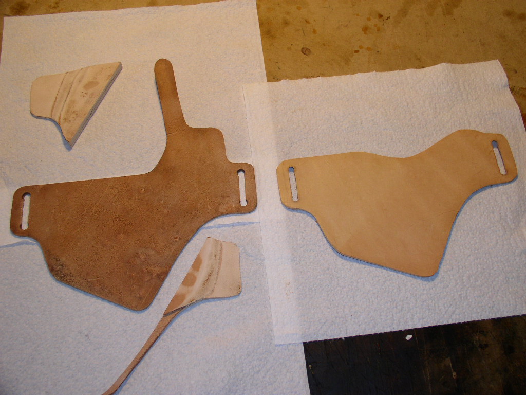

Contributing Member Jordan Posted July 22, 2008 Author Contributing Member Report Posted July 22, 2008 This is what I have come up with so far. I built up the innards to make some room for the light, still need to cut a thin piece for the front/ mouth area as customer wants basketweave trim plus I think it will help hold it open. I incorporated a strap that will wrap just beneath the hammer and snap to the afore mentioned trim strip. I still have to fashion a wood filler for the area behind the light for moulding. I decided (don't really know why) to have the strap part of the sweat shield and snap in the front. This holster is more a carrying bucket than a functional quicksdraw Mcgraw so far I am happy with it but as we all know the magic happens at the end. LOL Quote
Members Srigs Posted July 23, 2008 Members Report Posted July 23, 2008 Looks like it should work. Your a brave man cutting the belts slots before assembly. Let us see it when completed. Quote Srigs, http://www.sideguardholsters.com "If everyone is thinking alike, then somebody isn't thinking" - George S. Patton.
Members Shorts Posted July 24, 2008 Members Report Posted July 24, 2008 Looks like it should work. Your a brave man cutting the belts slots before assembly. Let us see it when completed. lol I've though about it but never have. They get cut fater stitching, before molding. It works for me Quote
