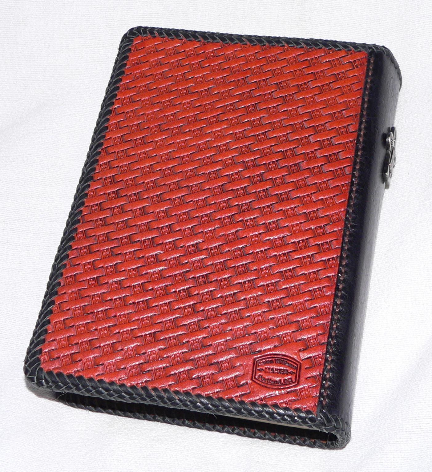

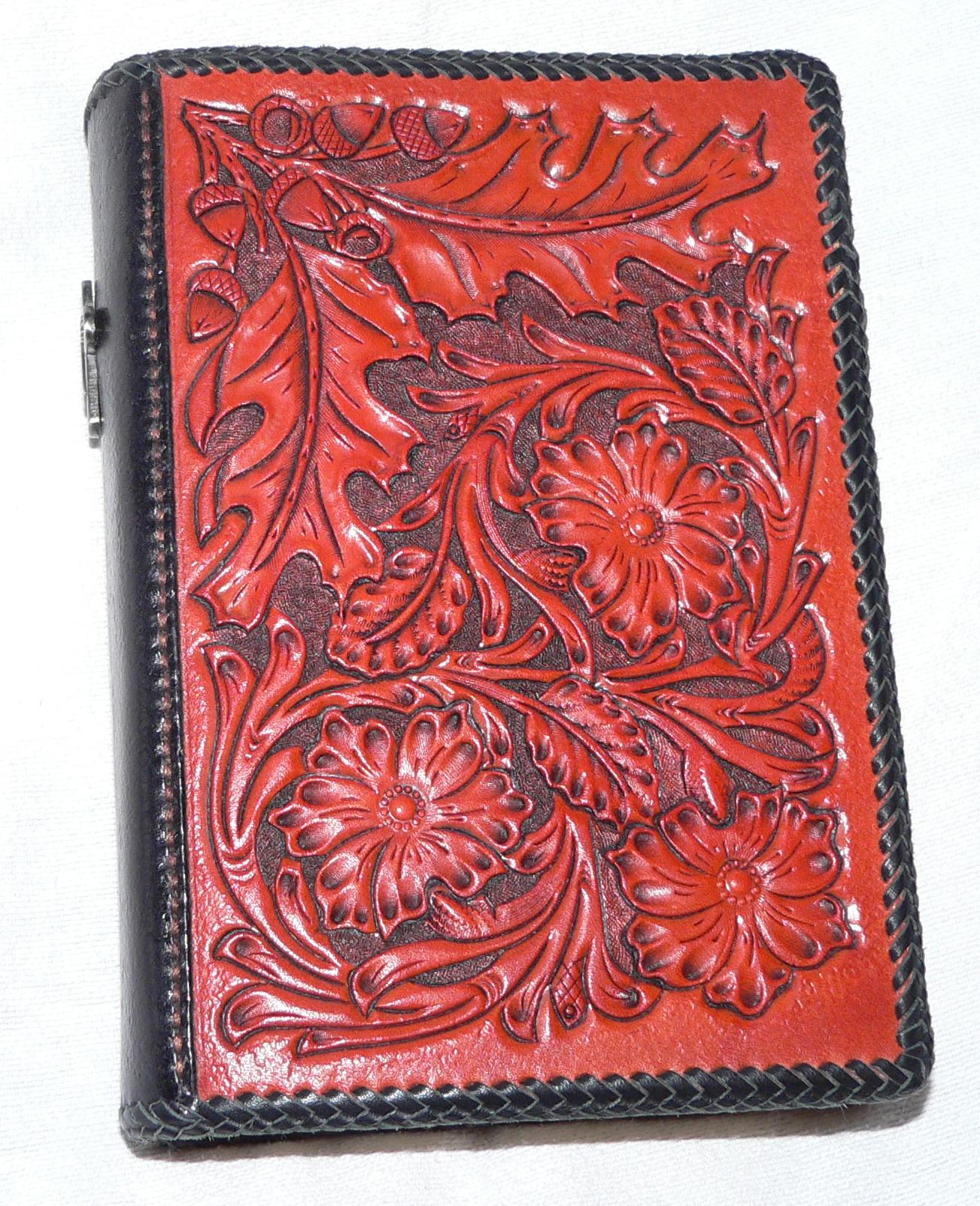

Think of it like a checkbook cover, only larger. It can be one piece or three, that is up to you. You also have a tuckable slot in the flaps for the bible to slide into. The one in the pics is a total of 5 pieces. The hardet part is making it fit snug without it being loose, you want it to fit like it belongs on it.
