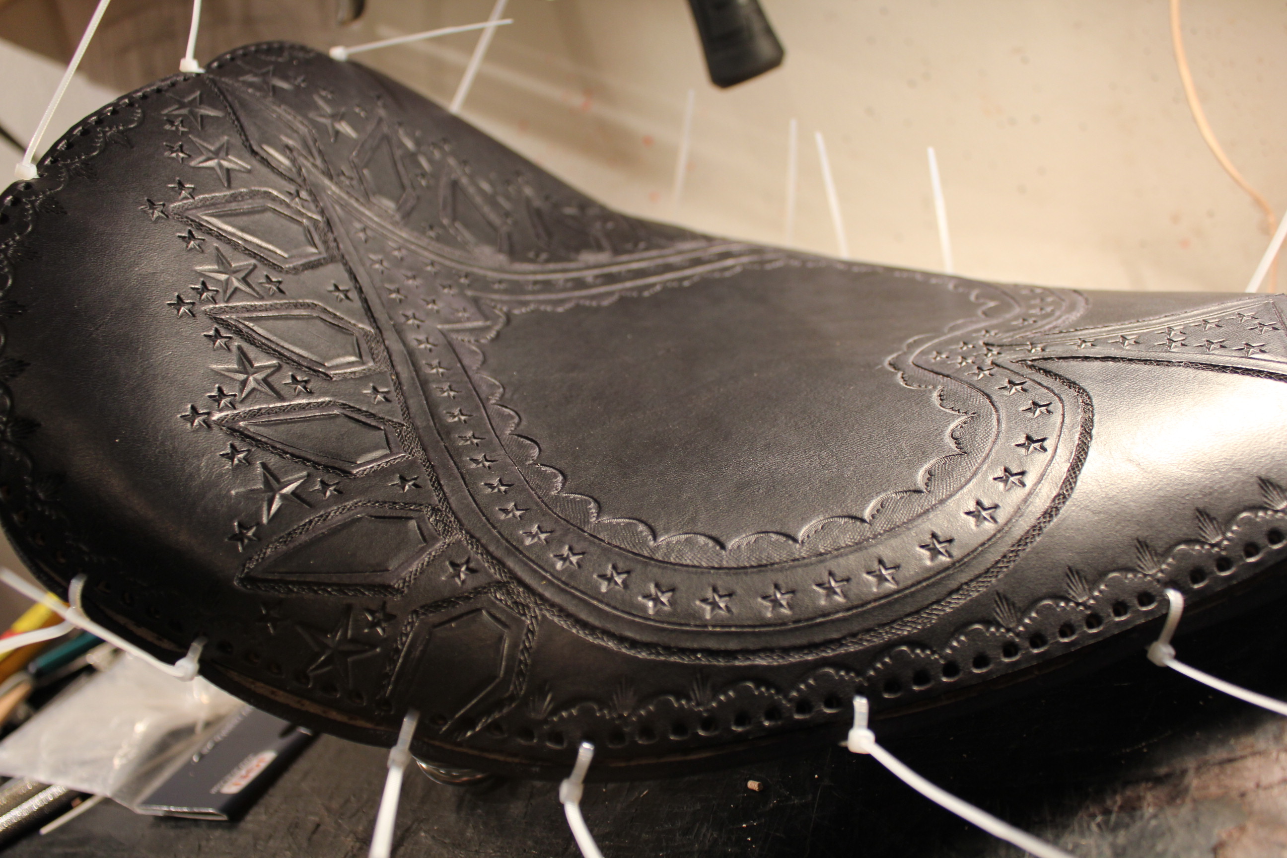

I use zip ties, I make the top first and using a wing divider go around the perimeter 5mm marking the bottom side of the leather. Glue on my bottom and cut off the excess.

post-28433-015016200 1339297757_thumb.jp
post-28433-090694100 1339297786_thumb.jp
