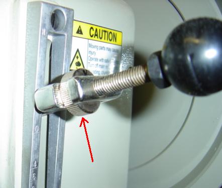

Tree Reaper Posted July 1, 2012 Author Report Posted July 1, 2012 (edited) Sure, glad to help. Make a stitch in forward and make a separate stitch in reverse. Pull the thread out of each run of stitches and measure the distance between the needle holes on both the forward and reverse stitch. They should be the same. If they aren't you can turn the feed regulator nut (marked with a red arrow) in either the forward OR the reverse lever position. In my case the reverse stitch was shorter so I turned the nut clockwise with the lever in the reverse position until the holes started opening up and finally measuring the same distance as the forward stitches. Keep stitching and measuring then turning the nut until you get the desired stitch distance. It took me about five different test stitches to get it where it had to be. Edited July 1, 2012 by Tree Reaper Quote
Members catskin Posted July 1, 2012 Members Report Posted July 1, 2012 Thank you Thank you Thank you. I checked mine out and it was OFF slightly about a 1/4 of a needle width in 5 stitches so I only had to turn the knob about an 1/8 of a turn. I am guessing we may have to check this each time we change stitch length. On 7/1/2012 at 12:56 AM, Tree Reaper said: Sure, glad to help. Make a stitch in forward and make a separate stitch in reverse. Pull the thread out of each run of stitches and measure the distance between the needle holes on both the forward and reverse stitch. They should be the same. If they aren't you can turn the feed regulator nut (marked with a red arrow) in either the forward OR the reverse lever position. In my case the reverse stitch was shorter so I turned the nut clockwise with the lever in the reverse position until the holes started opening up and finally measuring the same distance as the forward stitches. Keep stitching and measuring then turning the nut until you get the desired stitch distance. It took me about five different test stitches to get it where it had to be. Quote

Members JeffGC Posted November 2, 2012 Members Report Posted November 2, 2012 I've read this thread about 25 times and I am still a bit confused. When you adjust the regulator nut, I would think you are changing the stitch length in both Forward and Reverse. Am I to understand that the solution is to slightly adjust the regulator nut when changing to Reverse? When one returns to Forward, you go back to the original setting? Jeff C. Quote
