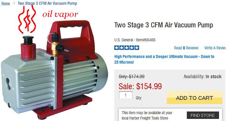

Members Retired LE Posted July 5, 2012 Members Report Posted July 5, 2012 (edited) Re: I wet the front piece and using my fingers and a vacuum bag to form it how I want around the weapon. I read your post and noticed your reference to the vacuum bag. I am in the process of trying to put together my own vacuum forming system (without spending the big bucks if possible). I have a pretty good idea how the system works and the components needed - but I am running into problems with selecting a vacuum pump. From what I have read, the hand held vacuum pumps take forever to reach a level of vacuum that will mold leather, and the wood veneer units are prohibitively expensive. In the middle of the price range are the electric vacuum pumps available from Harbor Freight. I purchased one of those yesterday (see attached pic) and after setting it up, I noticed it emits an oil mist out the exhaust while running. That might be ok for a mechanic working on AC system in a garage - but it's unacceptable for in home leatherworking - not to mention potential health issues. So anyway, to avoid becoming long winded here.... I was wondering what system you are using. Thanks for reading, Mike Edit: After posting this I realized i probably just hijacked this thread and should have started a new thread? Perhaps the moderators will step in and adjust accordingly? Edited July 5, 2012 by Retired LE Quote
Denster Posted July 5, 2012 Report Posted July 5, 2012 I read your post and noticed your reference to the vacuum bag. I am in the process of trying to put together my own vacuum forming system (without spending the big bucks if possible). I have a pretty good idea how the system works and the components needed - but I am running into problems with selecting a vacuum pump. From what I have read, the hand held vacuum pumps take forever to reach a level of vacuum that will mold leather, and the wood veneer units are prohibitively expensive. In the middle of the price range are the electric vacuum pumps available from Harbor Freight. I purchased one of those yesterday (see attached pic) and after setting it up, I noticed it emits an oil mist out the exhaust while running. That might be ok for a mechanic working on AC system in a garage - but it's unacceptable for in home leatherworking - not to mention potential health issues. So anyway, to avoid becoming long winded here.... I was wondering what system you are using. Thanks for reading, Mike Edit: After posting this I realized i probably just hijacked this thread and should have started a new thread? Perhaps the moderators will step in and adjust accordingly? That is the same pump I use. The oil mist is from a slight overfill and will go away shortly. If you have not yet purchased a bag let me suggest that you invest in the poly rather than vynal. The poly lasts almost forever and works a hundred times better for molding holsters than the vynal and allows for boning the details through the bag. Quote
Members Retired LE Posted July 5, 2012 Members Report Posted July 5, 2012 (edited) That is the same pump I use. The oil mist is from a slight overfill and will go away shortly. If you have not yet purchased a bag let me suggest that you invest in the poly rather than vynal. The poly lasts almost forever and works a hundred times better for molding holsters than the vynal and allows for boning the details through the bag. Ok thanks. I didn't realize there might be a break in period for this pump. The instructions were rather sketchy. I lieu of a vinyl or poly bag, I am going to experiment with a used inner tube that I picked up for free from the local tire store. I am working on an idea using pvc tubing to use as clamps/sealers on the cut ends. I also made up a vacuum hose using quick disconnect air fittings and a schrader valve fitting. Only problem I can see initially is that I won't be able to see through my homemade bag to see what needs to be molded - but I think the outline should be distinct enough. Will see how that works out. PS: Where did you get your bag and how much was it? Edited July 5, 2012 by Retired LE Quote
