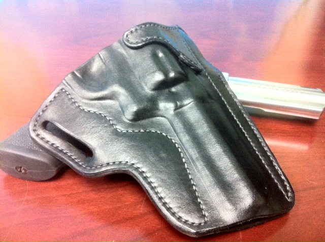

Members chiefjason Posted July 10, 2012 Members Report Posted July 10, 2012 What are you comparing yourself too? When I started out I looked at lots of professional holsters and decided what I wanted to be able to do eventually. First holster was OK, but comparing to other stuff I was not happy. Then I found out a lot of the very detailed holsters are pressed not hand molded. Not sure if you will ever get the detail by hand that you would with a press. Just make sure you are not comparing apples to oranges. My last holster I am very happy with. It's not what I may have originally wanted to be able to do, but now that I know I was comparing 2 different techniques it has changed my attitude about the details. My first few holsters were using 8-9 oz and I was able to get pretty good detail on them. Letting it dry a bit helps too. If the leather is too damp it has a tendency to not take the boning and you start to loose the details. If you have to go back and try to rework stuff it might be too damp. Quote
