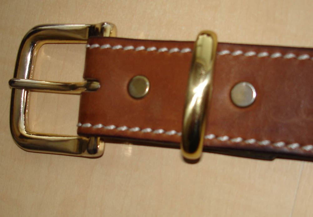

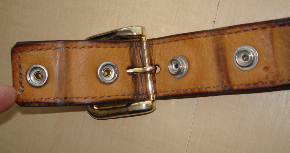

Hi there All
Thought Id chuck in my method of doing the snaps for belt blanks thing.
Its real easy and quite good if you want to change the buckle at any time. Works well with the trophy buckles that have no slot as well.
Firstly mark out where your two snaps need to go. Allow plenty of room back from the fold of the leather otherwise the snap will easily come undone. Also allow enough space between the snaps so the keeper can fit. This belt in the photos has about 1 1/2 " between the centers.
Next install the tops first in the fold over piece and set as per normal. (by hand setter or machine.) Next fit the keeper to the belt and press together by hand to mark the leather where the snaps actually sit. This will leave a tell tale mark on the leather to show where to put the next hole.
Next make a small hole (big enogh to get a 10 -12 mm) rivet through. then put the (Jiffy rivet I think you call them) through the hole in the eyelet and then into the hole on the belt.
This is where you actually rivet the eyelet onto the belt. Mount your setter upwards in the vice and place everything on top.
Then put the cap on to the rivet end and hit with the hammer. Set as per normal.
Note the rivet will form itself into the cup on the eyelet. This will allow the snap to work properly.
Good luck
Trevor
"Way down under"
"Every Day Above Ground Is Good"
Trevor - excellent! I really dig the way that's one. And thank you for the pictures. They make the explanation very easy to understand :)

Trevor, that looks like a neat way to install the snaps. What type of snap is that that you use (size or whatever)?
And how thick is the strap at the buckle end when snapped together?
Thanks much.
L'Bum
