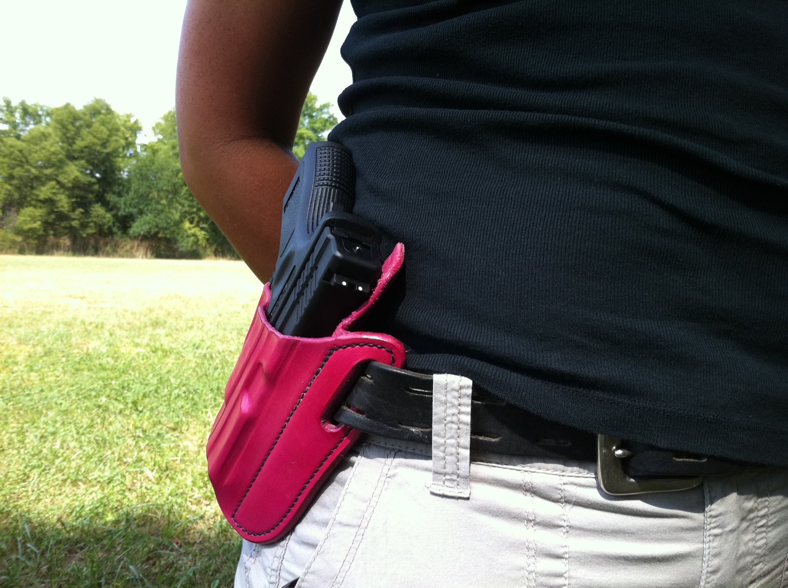

Members renegadelizard Posted August 12, 2012 Members Report Posted August 12, 2012 Here they are!! All pink and frilly...but my wife and her friend loved them so I guess I done good...Im not real happy with the stitch lines, too far away, but it seemed the leather stretched more than usual..i used a few drops of dish soap when i go them wet for molding..maybe that did it, as i usually don't use it...it also might be because the last half dozen holsters I made before these were with some of that really stiff HO that everyone has been experiencing lately...anyway, they work and they are "pretty", and if they loosen up, ill run another stitch line...enjoy and please don't take my man card away...lol.. Quote Havoc Holsters
Contributing Member TwinOaks Posted August 12, 2012 Contributing Member Report Posted August 12, 2012 It could be in part because of the soap. I read on here a long time ago to use a drop or two in water for casing, and have been doing it ever since. I'm pretty sure it works by breaking the water's surface tension and making it "wetter"....or....it penetrates the leather better. Quote Mike DeLoach Esse Quam Videri (Be rather than Seem) "Don't learn the tricks of the trade.....Learn the trade." "Teach what you know......Learn what you don't." LEATHER ARTISAN'S DIGITAL GUILD on Facebook.

Members renegadelizard Posted August 13, 2012 Author Members Report Posted August 13, 2012 What did you end up using for the dye? Jake I used the angelus Rose dye, cut 1:1 with mineral spirits...it was just the shade of pink my wife demanded...i should have charged her more for th etrouble..lol.. Quote Havoc Holsters
Members renegadelizard Posted August 13, 2012 Author Members Report Posted August 13, 2012 (edited) It could be in part because of the soap. I read on here a long time ago to use a drop or two in water for casing, and have been doing it ever since. I'm pretty sure it works by breaking the water's surface tension and making it "wetter"....or....it penetrates the leather better. I think you are right, or a combo of both the soap and leather...with the "super hard" HO, I would have to soak it sometimes for 30-40 seconds just to be able to spread the holster open to get the gun in...this was an 8 second duck and it came out sloppy wet....even after I let it dry out a bit it was still pretty stretchy...and of the two holsters, one was much firmer than the other after baking it...cant figure that one out either.. i think after i use up what I have left, im going to take a page out of Katsass's book and start going with 2 layers of 5 ounce glued together...it will cost more, but I think it will make a better holster and it will allow me to start playing more with inlays... Edited August 13, 2012 by renegadelizard Quote Havoc Holsters

Members DHopper Posted August 14, 2012 Members Report Posted August 14, 2012 If the ladies are happy then you are happy!! They look pretty darn good. Well done!! My local boot maker told me about dish soap to help in molding some super dense veggie tanned hide I was working with. Before it just did not want to stretch and form well, but the soap really did the trick. Quote Dave dhcustomwork.com
