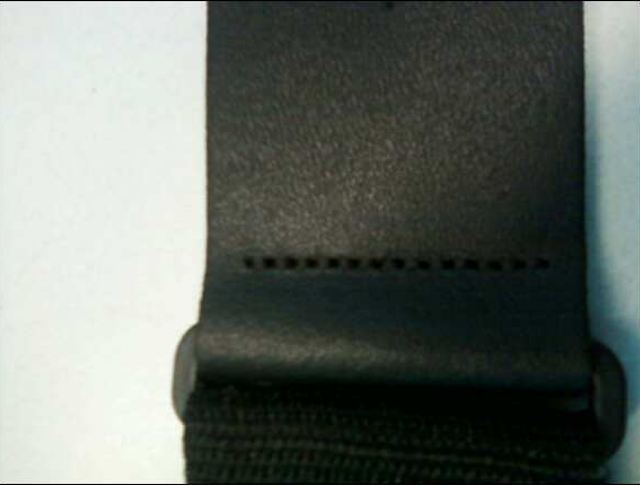

Members Joudodo Posted August 13, 2012 Members Report Posted August 13, 2012 I'm sewing a leather end on a guitar strap (pic attached). The leather piece I am sewing is about .085 inches thick, I'm sewing the folded bit so I'm sewing through about an 1/8 inch of material. I broke a few needles so I have a few questions...first what size needle would you guys recommend? Second, I am using an industrial sewing machine, a Mitsubishi PLK-B series, and I am a little confused about industrial needle systems. Do I have to use a specific needle system for my machine or will any needle system work as long as its an industrial round shank needle? Finally what speed would be appropriate for sewing something like this? Thanks! Quote

Members Joudodo Posted August 14, 2012 Author Members Report Posted August 14, 2012 x5= round point,x8= leather point Bob awesome, maybe you can help me out with one final question. The picture I posted in the OP was sewn with a size 125/20 needle, what size would you recommend for a leather point needle making that same stitch? Quote
CowboyBob Posted August 14, 2012 Report Posted August 14, 2012 (edited) Singer made these numbers up years ago to ID the different points like the longer 135x17 (round point) chnges to 135x16 for a leather point. THEN to confuse the issue even more there is different types of point like right twist,left twist,narrow wedge & the one most people like to use in this type is diamond point it will make the best looking stitch.The twist points will give you a stitch the looks zig-zag & diamond point runs in a straight line. HTH Bob Edited August 14, 2012 by sewmun Quote
