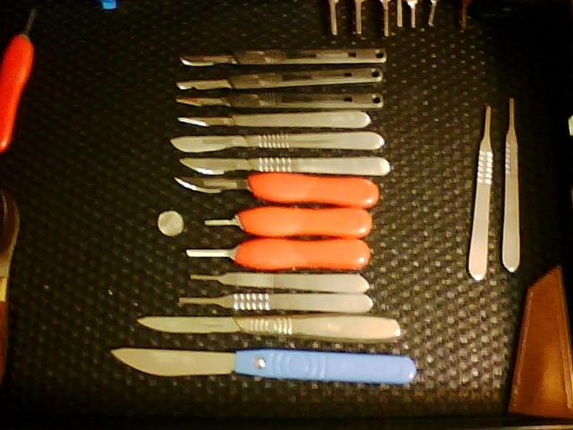

Art Report post Posted August 25, 2012 Top is a Swann Morton retractable handle (available in #3 only) with a #10 blade Next a retractable with a #15 blade Next a retractable with a #11 blade Next a standard #3 surgical handle with a #11 blade Next a standard #4 surgical handle with a #22 blade Next a standard #4 surgical handle with a #24 blade Next a #4 craft handle with a #24 blade Next a dime and a #3 craft handle Next a #4 Craft handle Next a #3 Surgical Handle Next a #4 Surgical Handle Next a #8 Post Mortum Handle and a PM60 blade Next a PM 40 handle and a PM 40 blade Art Doug, I'll get some pics tonight and post them. Art Quote Share this post Link to post Share on other sites
CustomDoug Report post Posted August 25, 2012 (edited) Wow Art, that's quite the collection of scalpels you have. Thanks for posting that. I'm sure I'll end up with a few of those too down the road. I'm thinking I'll give the clicker blade idea a go first. Thanks everyone. Edited August 25, 2012 by CustomDoug Quote Share this post Link to post Share on other sites

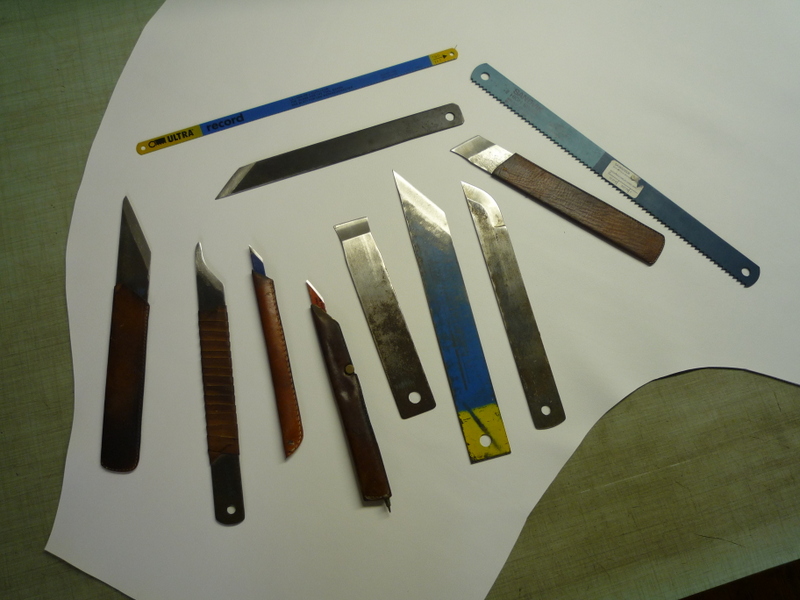

Leather Guru Report post Posted September 3, 2012 (edited) I make my own knives using High speed steel hacksaw blades ( NOT BI METAL ) Grind off the teeth with an angle grinder ,shape the point & sharpen on one side . I have been using this type of knife for 25 odd years . You'll need a diamond sharpening stone as the steel is very hard & even if when sharpening with your belt sander you heat up the blade HSS does not loose it's temper (like we sometimes do ) . Make sure the blades you buy are not BI METAL ! Here's a video of me using such a knife . http://www.youtube.c...h?v=hoiidrC0Nqc Plese excuse the ugly gesture at the end of the video Edited September 3, 2012 by Leather Guru Quote Share this post Link to post Share on other sites
CustomDoug Report post Posted September 3, 2012 Wow, man I'm impressed!! I like that idea, will give it a try I'm sure too. Tell me about the handle you have there.. did you make it, and how ? Quote Share this post Link to post Share on other sites
Leather Guru Report post Posted September 6, 2012 Hi brother , I put some pics on Picasa web albums I'll find the link ? ? ? The knife handle is called L'indisponsable & it's coming from VERGEZ-BLANCHARD but U can make your own handle your self ; Use your ingenuity Wow, man I'm impressed!! I like that idea, will give it a try I'm sure too. Tell me about the handle you have there.. did you make it, and how ? Quote Share this post Link to post Share on other sites
Leather Guru Report post Posted September 6, 2012 I'm trying to find the pics of my collection of knives made from high speed steel saw blades Quote Share this post Link to post Share on other sites
