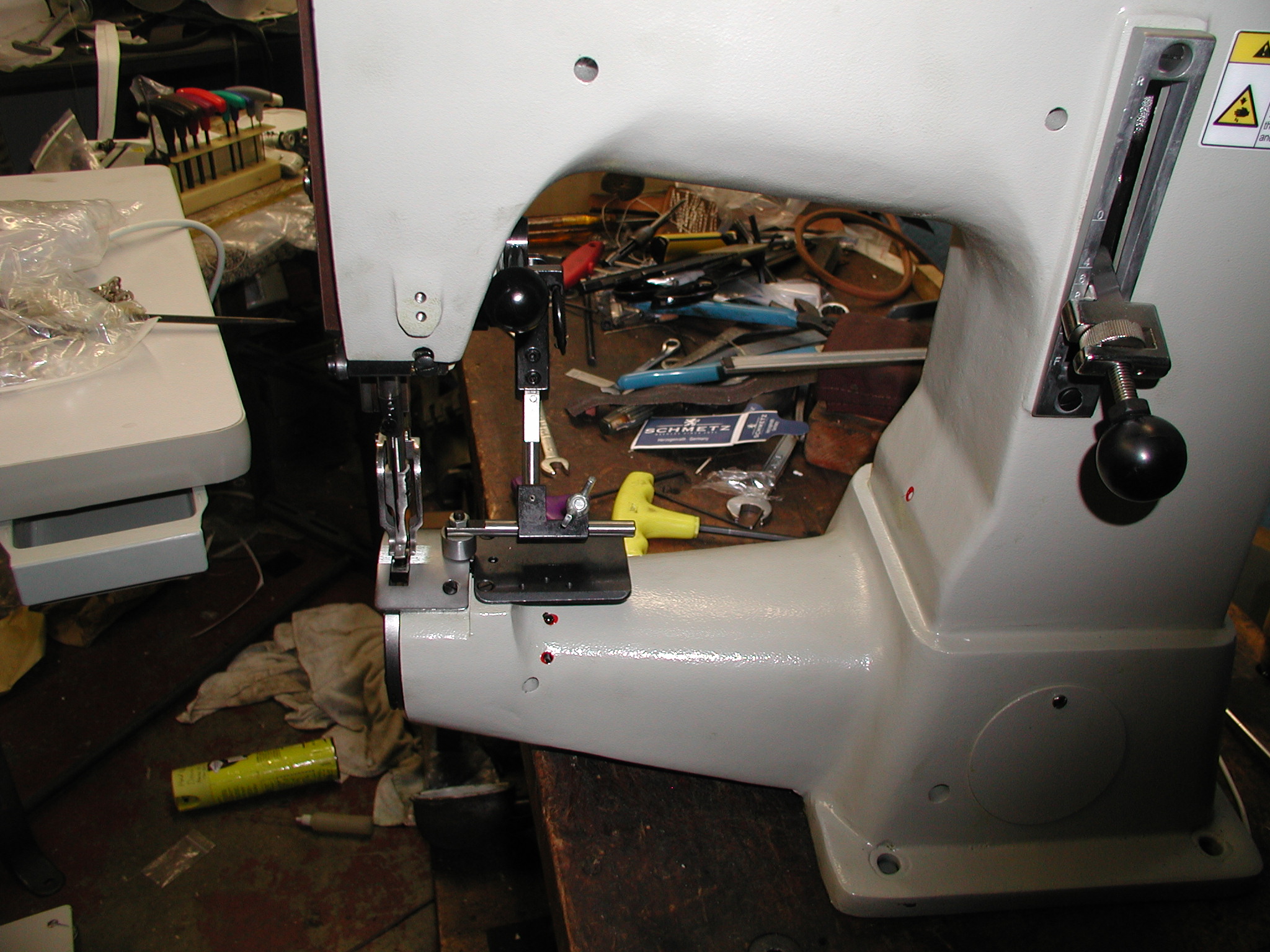

Contributing Member SooperJake Posted August 28, 2012 Author Contributing Member Report Posted August 28, 2012 (edited) I could use pictures of the drop down belt guide installed. Preferably one in the 'up" position, and one in the "down" position. CB4500 Thanks, Jake Edited August 28, 2012 by SooperJake Quote Once you know what the magician know.... it isn't magic anymore.
