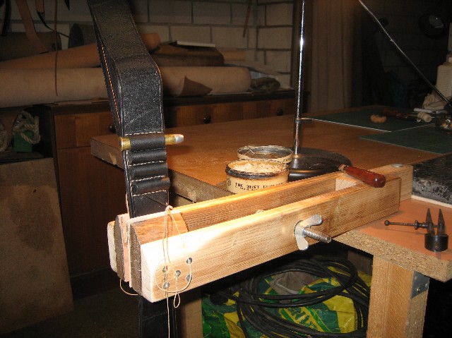

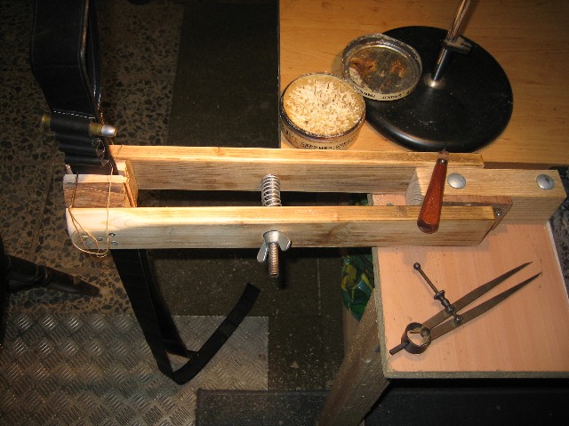

Well i thought i would reinvent the wheel...LOL
this is the lazy pony i have been toying with this idea for some years but never found time to get around to build it,
i got the idea from stitching loops on the belt but no matter how you try and place the belt in the stitching horse its always interfiering with the tension spring in the middle, and each stitch you have to flip the belt to the left and then the right so this is what ive come up with,
its a pony/ horse clamp on its side with the jaws upright and a sky hook in stalled so i can pull the belt upward to stop the fliping from left to right and the belt hangs straight down, its very basic as its sunday and had to use what i had at home (stores arnt open) ive tried it out and found it better than my expensive horse, its compact and removable and easy to store away when its not needed, Don

Great idea and nicely made!
ArtS
Excellent work Don! I've been needing a pony for my holsters and really been wanting a pony to start belt since I don't have a sewing machine. Its interesting how the best tools and jigs are made on days where the stores are closed and you have to Macgyver the project with the itemsyou have on hand. Yours doesn't look Macgyvered! lol
What a cool idea!
