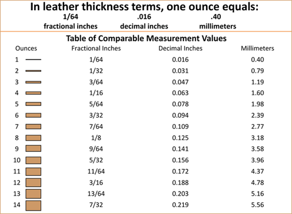

I got this great tip from the Bettuns Village Leather web site. I too have a collection of scraps I needed to figure out and I use this method.
"As a general rule, each ounce of thickness is roughly equal to 1/64 of an inch in thickness.
As an example, 8 oz leather is 8/64" thick, which is the same as 1/8".
Some simple examples of thickness based on US coins:
A dime = 3 oz
A penny = 3.5 oz
A quarter = 4 oz
A nickel = 4.25 oz
So, dig this:  6 oz leather is like two dimes stacked one atop the other.
8 oz is two quarters stacked together.
12 oz is three quarters stacked together."

Tooling, thanks for that post. Such a simple / easy way to gauge thickness with what's in your pocket.
