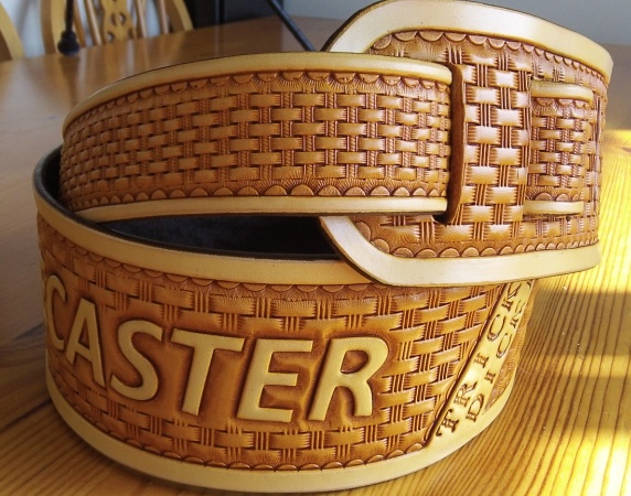

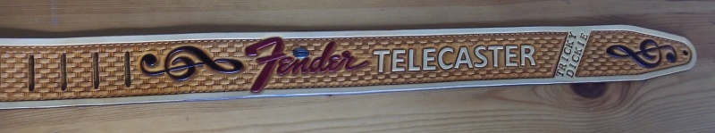

Members Bigfoot Posted October 4, 2012 Members Report Posted October 4, 2012 Don't know if you've done it yet but here are some pics of my first guitar strap that i just finished. The notes are dyed black, the "Fender logo" is dyed oxblood and then the telecaster letters and all the other light coloured areas were given 2 coats of block. Then the whole thing was then gone over using undiluted saddle tan highlighter and wiped off again. Hopefully that will help and give you some ideas Quote
Members DoubleC Posted October 4, 2012 Author Members Report Posted October 4, 2012 LOL, I was the one who suggested you paint a guitar in oxblood where you had the ooops. It's a beautiful strap. I'm going to do all the strap dark brown, and then put resolene on it, and use tan antiquing on the carved and stamped parts. Then I think I'll do the smaller connecting strap in tan to even out the lights and darks. I'd love to get my hands into some oxblood, or some other cool dyes on this, but the customer wants browns. And the customer is right.....right? Cheryl Quote http://www.etsy.com/shop/DoubleCCowgirl
