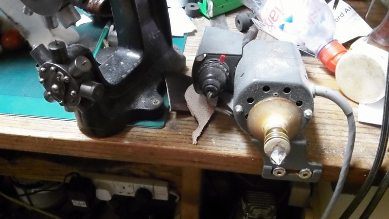

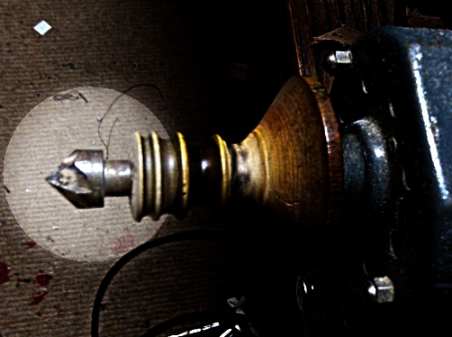

Members Bigfoot Posted October 11, 2012 Members Report Posted October 11, 2012 This is my prototype burnisher, made out of an old cotton reel and an old sewing domestic machine motor with a foot controler bolted to the table.....It does work OK and simple to make as I just glued the spool to the shaft and then turned the spool to the groove sizes that I wanted using files, gauges or anything else that was the right size. I'm gonna replace the spool with a nice piece of hardwood when i find something suitable and then it should be very good....even if the speed can be a bit erratic! Quote

Members Horrrk Posted October 11, 2012 Members Report Posted October 11, 2012 Ingenious setup Bigfoot and I reckon that Ben Hur would've been proud of the end of that spindle..lol Regards Phil Quote Being defeated isn't the worst thing in life..giving up, is..
