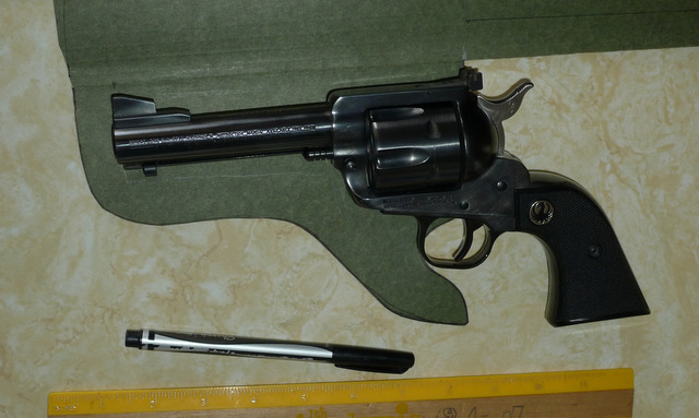

Here are a few shots of what I've done so far....
Well, I dug around and found some dark leather I had stashed away. It's thinner than the holster leather and will provide a wonderful contrast. I'm not sure exactly what to do as far as design is concerned, but I'd like to have the light and dark playing off each other. I was wondering if dark leather can take tooling/art work. It doesn't seem to me like it would show up very well. Thanks for any suggestions.

use the darker color for your band. if you go that route and not line it, be sure to dye the inside of the holster to match.

i would line it with the dark and go with white thread...stitch every seam before folding it over and sewing the rest of it together...it looks like its a slim jim design, so the sewing wont be nearly as bad as it would be on a mexican loop holster...my first holster was a revolver as well...good choice for a first piece...oh, and i just didi the opposite of you....i wanted to cut out a pattern for a sig 1911, but i wanted mine flesh out so i could overlay it with fake ostrich ...i cut ti the normal way of course...lol...gotta start writing more on my patterns...crossdraw avengers seem to be my nemesis here lately....good luck and post some pics when you are done...

From the grump; Looks like you are using Al Stohlman's book to learn with, I think I'd just attach a band (forming a loop) of your dark stuff to the end of the belt loop already cut, and make the thing into a 'half-skirt'' holster. You could then (if you are working on a real tight budget and don't have the dye) wet the thing down in some old, real strong (cold) coffee for the wet molding process. That would give you some color to the body of the holster, and a nice contrast with the retaining band, when dry and formed, apply your finish.

Made a little more progress on the holster tonight. After throwing around a bunch of ideas, I just decided to stay simple. I stitched on a dark decorative band. Then a hammer spur strap, and finally the belt loop. Next I'll cut the edge filler and stitch her together.
Cut the filler and added extra filler to top and bottom, skiving to blend in.
Stitched it all together, and took a walk in the desert. Performed as I had hoped. Now I need to finish it. After touching up the profile and burnishing, do I rub in oil then apply Mike's "Mop N Glo"? Do I "Mop N Glo" first and then oil? Do I just "Mop N Glo" but not oil? Thanks!
