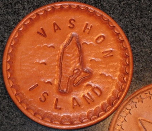

I have a simple way to depict waves and put it around the image of an island.
I use a V821 Craftool Veiner Stamp
post-15330-0-76366100-1353000773_thumb.j
You can use it straight on, or tip it
post-15330-0-98305000-1353000945_thumb.j
I hope this helps
