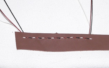

electrathon Posted November 18, 2012 Report Posted November 18, 2012 You use 3 threads and move forwards one one the front and two on the rear, stagering forwards. The back will not look as good as the front. Quote

electrathon Posted November 18, 2012 Report Posted November 18, 2012 There are three threads, Each thread does every third stitch. You are sewing one thread at a time. Move over and do it again, next thread does every third stitch. the final thread fills in the final space. the back does not look as good as the front. It is easier to demonstrate than to explain. Aaron Quote
Members WinterBear Posted November 18, 2012 Members Report Posted November 18, 2012 If you're using a welt, you can run the extra thread between the welt, so you only show one thread front and back, albeit each stitch on both sides will show in different colors. Quote I used to be an Eagle, a good ol' Eagle too...

Moderator immiketoo Posted November 18, 2012 Moderator Report Posted November 18, 2012 MAn you guys lost me on that one. I have no idea how that works, regardless of how the back side looks. Is it each an individual saddle stitch? Quote Learnleather.com
