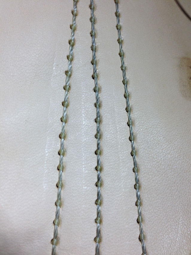

Members Wager Posted December 9, 2012 Members Report Posted December 9, 2012 Hi Leatherworkers! I've been following the forum for a while, and because of the great info on this site I just purchased a Cobra Class 4. I just picked it up today and couldn't be happier. To get a little practice under my belt, I did my first few stitches on some scraps. Although I saw Steve do some really nice stitches, I'm unable to figure out how to solve the problem in this picture. My bottom thread doesn't seem to be pulling through far enough. The leather in the picture is 2 pieces of 2/3 oz veg tan. Any help would be greatly appreciated! Thanks, Joe Quote
Members gottaknow Posted December 9, 2012 Members Report Posted December 9, 2012 Hey Joe. Either your top tension is too tight, or your bobbin tension is too loose. I usually start loosening before tightening, so loosen your top tension a little at a time until the stitch is balanced. You can also do a little of both. Tighten the bobbin tension a little and loosen the top a little. You'll figure it out in no time. Enjoy your new machine! Regards, Eric Quote
Members pcox Posted December 9, 2012 Members Report Posted December 9, 2012 (edited) If thats the bottom you need more top tension. so thats the top forget what I said. Wizcraft & gattaknow has you on track Edited December 9, 2012 by pcox Quote
Members Wager Posted December 9, 2012 Author Members Report Posted December 9, 2012 Thanks guys, that's the top. It seems a bit tricky to tighten the bottom tension on the class 4, unless there's something to it I'm not seeing. I'll keep at it, any more tips would be greatly appreciated! Quote
Moderator Wizcrafts Posted December 9, 2012 Moderator Report Posted December 9, 2012 If the photo is taken from the top of the leather, either the top thread is wrapped incorrectly around something it shouldn't be wrapped around, including itself, or a post, or one of the 2 disk sets, or the bobbin thread has come out from under the bobbin tension spring. If the photo represents the bottom of the leather, either the top thread has come out of the tension disks, or is not feeding through the take-up lever, or the bobbin thread is too tight, or the needle is too big, or the thread is too big for 6 ounces of leather. Quote Posted IMHO, by Wiz My current crop of sewing machines: Cowboy CB4500, Singer 107w3, Singer 139w109, Singer 168G101, Singer 29k71, Singer 31-15, Singer 111w103, Singer 211G156, Adler 30-7 on power stand, Techsew 2700, Fortuna power skiver and a Pfaff 4 thread 2 needle serger.
Moderator Wizcrafts Posted December 9, 2012 Moderator Report Posted December 9, 2012 On 12/9/2012 at 3:50 AM, Wager said: Thanks guys, that's the top. It seems a bit tricky to tighten the bottom tension on the class 4, unless there's something to it I'm not seeing. I'll keep at it, any more tips would be greatly appreciated! Yeah, I Grok your pain. There is a little flat blade screw inside a hole in the bobbin case, forward from the tension spring screw. The screw inside that recess locks down the tension screw. Use the small screw driver that came with the machine to loosen the set screw, then adjust the tension screw for more bobbin tension. When you are happy with the back pressure, tighten the set screw to keep the tension screw from backing out. Quote Posted IMHO, by Wiz My current crop of sewing machines: Cowboy CB4500, Singer 107w3, Singer 139w109, Singer 168G101, Singer 29k71, Singer 31-15, Singer 111w103, Singer 211G156, Adler 30-7 on power stand, Techsew 2700, Fortuna power skiver and a Pfaff 4 thread 2 needle serger.

Members Andrew Chee Posted December 9, 2012 Members Report Posted December 9, 2012 Just out of curiosity, what size thread do you have in there? Looks pretty heavy. A heavy thread in something as thin as two layers of 2-3 oz is a little more difficult to get the knot in the middle simply cause the knot is so big. If you're sewing something this light, try a lighter thread as well. Andrew Quote
Members Wager Posted December 9, 2012 Author Members Report Posted December 9, 2012 I'm using 277. I finally got it somewhat dialed. The thicker leather worked best for sure, and I'm pretty convinced it's the size of the thread for the thickness of leathere I'm sewing. Thanks for the help all! Quote
Moderator Wizcrafts Posted December 9, 2012 Moderator Report Posted December 9, 2012 You should move down to #138 thread if you want to sew 4 to 6 ounces. #207 would be as large as you could really.sew at that thinness. You should use a #23 needle for #138 thread, or a #24 for #207 thread, top and bottom. Quote Posted IMHO, by Wiz My current crop of sewing machines: Cowboy CB4500, Singer 107w3, Singer 139w109, Singer 168G101, Singer 29k71, Singer 31-15, Singer 111w103, Singer 211G156, Adler 30-7 on power stand, Techsew 2700, Fortuna power skiver and a Pfaff 4 thread 2 needle serger.
