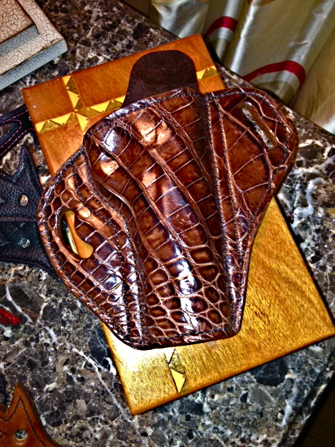

The more I use gator the more I like it. Ever so unique. I normally don't use conchos on OWB rigs but this one seems to fit and not one you can buy at any tandy store. We'll see if it helps it sell!

Yes, Govt.
Not sure what you are referring to on the "stitch line being way off". Any time you are using a 3-5oz exotic that covers 7-8oz veg tanned the 90 deg curve stitching right below the trigger guard can not be as close as if it were only 7-8oz veg tan. Gator in particular can vary in thickness depending on the length of the hide. For example a 10 foot hide may be 5-6oz. If the tannerery makes it any thinner they run the risk of cutting holes in between the scales since they are larger and much more pronounced. 4-6 foot gator hides are usually 3-4 oz. The veg tan below is molded tightly to the contours of the 1911. Is that what you are referring to?
The profile of the triggerguard is what I was talking about. I meant no disrespect. The stitch line is critical, and if you feel that it can't get close because of the combined thickness of the front panel, then it would make sense to go lighter on the lining to achieve a tight line. A full coverage exotic is an investment and a tight, long-lasting line is completely necessary.
My 2¢.
No disrespect taken. :o) As long as the compression from stitch line is tight to the front panel, and from the front panel to the veg tanned below, there is little room for movement... provided of course the the veg tanned below is formed tight to the pistol. American alligator is indeed expensive, and not the hide you want to use without some experience in full coverage builds.
On an ancillary note, I find that using the smaller (and thinner) hides (4-6 foot)are better at showing the boning lines. Perhaps more noticable on the 1911 since the lines are readily recognizable. However the larger gnarly scales have their own unique beauty and seem to appeal equallly to many.
