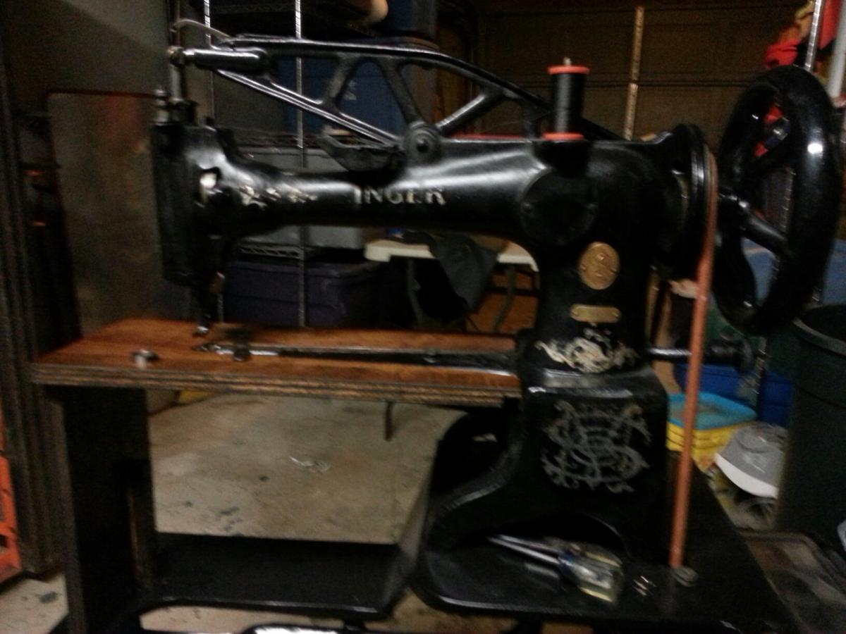

Members Sylvia Posted January 7, 2013 Members Report Posted January 7, 2013 Most of these require the bobbin while sitting in the case with the bobbin facing you to unspool counter clockwise (anti-clockwise). Meaning that when you draw the bobbin thread from the case, the bobbin will spin anti-clockwise Here's a service manual for a 29u-XXXX Most of the information should work for you. (it also has a better picture of the bobbin going into the case http://www.parts.singerco.com/IPsvcManuals/29U171A_172A_173A.pdf Here's a parts list that might help some too. http://www.parts.singerco.com/IPpartCharts/29-4.pdf Here's mine Hey... why don't you send that to me. I love old heavy singers. Quote A teacher pointed at me with a ruler and said "At the end of this ruler is an idiot." I got detention when I asked "Which end?"

Members Nightshade Posted January 7, 2013 Author Members Report Posted January 7, 2013 @Chris...thank you I wonder if the problem is that the arm that puts pressure on the tension disks from the foot. It hung up a couple times and the foot wouldnt go down. Maybe that arm got tweeked when it hung up? Quote
