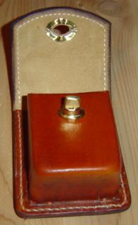

Tree Reaper Posted January 15, 2013 Report Posted January 15, 2013 I've started a run of belt pouches. Quote
Members bluesman1951 Posted January 15, 2013 Members Report Posted January 15, 2013 This is a winner !!!!!!! It will sell no doubt ! Now for the other 20 sizes you are going to make . LOL Good luck with this it should give you lots of good hours at the bench . Imagination is the key here ,lots of potential with this project . Every thing looks good sewing ,forming just over all very appealing . My compliments ,well done ! Bill Quote
Tree Reaper Posted January 16, 2013 Author Report Posted January 16, 2013 Thanks Bill. I added some suede to the inside to dress them up a bit. Quote
Members bluesman1951 Posted January 16, 2013 Members Report Posted January 16, 2013 Nice touch personaly I think this will keep you as busy as you wish to be . My sincere compliments well done Quote
mlapaglia Posted January 16, 2013 Report Posted January 16, 2013 Very nice, What weight is the leather on the outside? Quote The key to immortality is first living a life worth remembering. Bruce Lee
Tree Reaper Posted January 16, 2013 Author Report Posted January 16, 2013 Thanks, I'm using 5 oz. Quote
Members Mijo Posted January 16, 2013 Members Report Posted January 16, 2013 Looks good, I like the hardware you chose (fancier than just a plain snap). Quote
Members Blazin Posted January 22, 2013 Members Report Posted January 22, 2013 Nice looking pouch. What was the mold? Quote http://www.leathersheaths.net/ http://www.facebook.com/GillsCustomLeather
Members David8386 Posted January 22, 2013 Members Report Posted January 22, 2013 Good looking pouch, I like the look and color of it. David Quote
Tree Reaper Posted January 22, 2013 Author Report Posted January 22, 2013 Thanks for the comments. The mold is a cedar block that is milled out with a router bit, a matching insert that is just smaller by the thickness of leather is pressed into the mold on top of the leather. I'll now make the same mold out of hardwood so it will last longer. Quote
