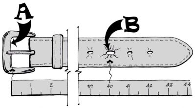

Chief31794 Posted January 21, 2013 Report Posted January 21, 2013 (edited) Here is a diagram that I give folks who want to order a belt. It helps them visualize what you're looking for. I tell them to measure to the most worn hole, then I make that measurement the center hole on the new belt. Edited January 21, 2013 by Chief31794 Quote

Members billymac814 Posted January 21, 2013 Members Report Posted January 21, 2013 I used to measure from the fold like I seem on some other sites, up until I had my first mistake. Now I measure from like the diagram in the previous post. The only way I would do it from the fold is if the customer is providing the buckle and the buckle. Quote

Members billymac814 Posted January 23, 2013 Members Report Posted January 23, 2013 What about it? It gets measured in with the belt so if the customer has a buckle that is 3" long and his measurement from the end of the buckle is 38" and if I'm using a 2" long buckle I still make it from the end of my buckle to the center hole 38". If I'd have him measure from the fold his new belt would be an inch short. I usually sell about 10 belts a week and never had one mistake doing it that way. Measuring it from the fold only works if you're only providing the belt and the customer is providing the buckle and even then it can be sketchy unless you know for a fact he's using in the buckle that he intends to use with the belt that he's measuring. I also have a belt made that's about 6' long with holes running most of the length of it each numbered in inches so when a customer comes in I have them put on the belt and I take down the number which is the measurement. This of course only works for people who come into my store though and even then ill usually just take the belt they are wearing and use that for my measurement but in some cases they don't always have a belt on and then I use my long belt. My long belt also has part of it border stitched, part of it is creased around the edge and part of it has some boarder stamping on it which are all additions that they can see and add to their belt and it has the prices for these additions written on it as well. I sell more single layer belts than I do concealed carry belts but they all get measured the same, I do tell people that get gun belts to make sure they measure the hole that they are using with the holster in place. On 1/23/2013 at 5:13 AM, Shooter McGavin said: but what about the buckle? Quote
