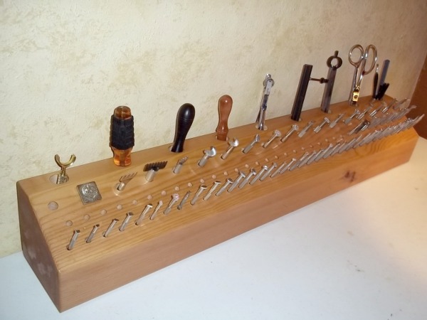

Members benlilly1 Posted March 5, 2013 Members Report Posted March 5, 2013 Decided I was tired of sticking my stamps in a 1" piece of styrofoam. So this weekend I made a tool holder out of a 6x6 piece of cedar 3 ft. long with 97 holes. I have empty holes but hoping to fill those up soon. Quote
Members Sir Derrin Posted March 5, 2013 Members Report Posted March 5, 2013 Very nice! What spacing did you use on the holes? Quote

Members benlilly1 Posted March 5, 2013 Author Members Report Posted March 5, 2013 First 2 rows are 1" apart for my smaller handled tools. 3rd row 2" apart and they are 7/16 holes. 1" holes in the back for holding my other hand tools. I couldn't keep my work space picked up so this was really needed. Thanks for the comments! Quote

Members benlilly1 Posted March 5, 2013 Author Members Report Posted March 5, 2013 Thanks everyone!! DoubleU that is exactly how I work...all tools spread out on both sides of me. Hopefully this will keep me more organized. I might put the stamps I use most right in the middle for easy access. I have a special spot for this holder...hence the size 6x6x3' for a future topic. I got this cedar on Craigslist for $5 so the cost and my labor makes it cheap and custom. Quote

Members KurseD Posted March 5, 2013 Members Report Posted March 5, 2013 I just bought a piece tonight to do one for myself. Your's looks outstanding. What did you use to treat it with? Quote
Members benlilly1 Posted March 6, 2013 Author Members Report Posted March 6, 2013 KurseD, 3 coats of poly. It could have taken more. It really soaked it in. I didn't have my spray unit set up so I brushed it. Quote
