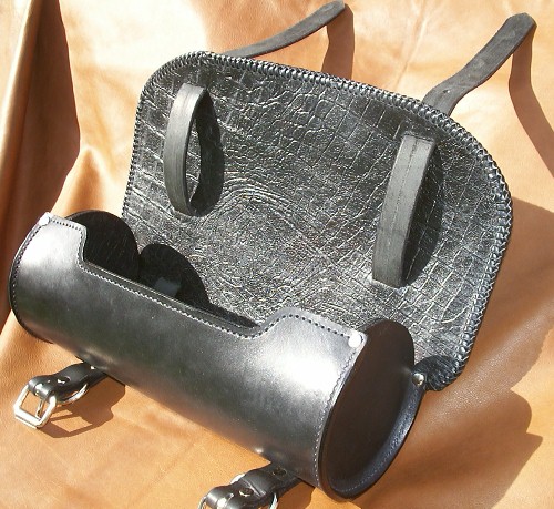

Corey, I use whatever upholstery leather I have on hand (the picture is of some phony croc embossed leather I have)- using spray adhesive. I cut the lining away from the edge where there is going to be a seam. I'm thinking of doing future bags with vinyl lining.

Not sure that will help. It might hurt. Unless you can keep moisture out completely you may just stop the breathing of the leather and cause damage inside because it can't dry out.
I have found it VERY difficult to keep moisture out of my toolbags. I just ash canned one which was made of heavy leather and had braid all around the bag. The braid on the round ends caused so many holes that the leather tore once it started to rot. The weight of the tools was a stress that the seams simply could not bear over the long term. The rot came from moisture trapped on the inside of the bag. I am thinking of putting drip holes on my next one with a little shield to prevent water from coming in but it will allow it to escape.

i had to respond to this - especially to bree's comments, despite the fact that this thread is pretty old.
it has to do with waterproofing a toolbag. i've noticed that most (if not all) tool bags have the straps going through holes in the top cover (like the one that ian has pictured - beautiful by the way). this is automatically a place for rain to enter. and based on the size of the punch used, a LOT of water will enter there. this can rot it out or possibly delaminate the lining from the outer leather.
what i've done to mine is this: (and i really apologize for not having pictures of this, so i'll try to describe it as best i can) i attach the 2 straps to the face of the bag where the top lip is. i punch 2 holes for the straps in the lid and as the lid is pulled down, you can thread the straps through the punched holes and secure it with a buckle or snaps on the bottom of the bag.
another wat to do it is to have "d" rings on the leading edge of the lid and have some straps secured to the bottom of the bag. close the lid, run the straps through the rings and snap it closed with snaps (or buckle, or velcro) to the bottom of the bag.
this way, there is no opening in the lid for rain to get in.
