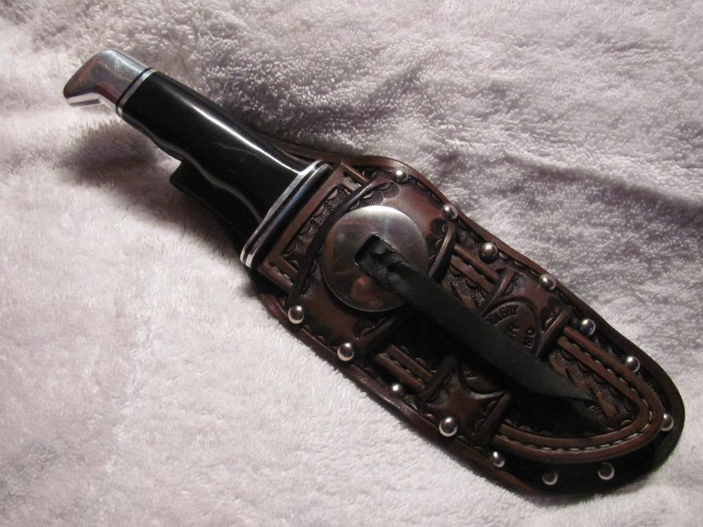

Josh Ashman Report post Posted March 22, 2013 Blingy double loop knife sheath finished today. 10-11 HO Fiebings antique black liquid over two light coats of NF oil with 50/50 M&G-water. Thanks for looking, Josh Quote Share this post Link to post Share on other sites

Phatdaddy Report post Posted March 26, 2013 That is very nice! So with these; the back part of the sheath and the part with the loops is all one piece? Add the welt and front and then wrestle the sheath through the loops? Is there a welt? Kevin Quote Share this post Link to post Share on other sites
Josh Ashman Report post Posted March 26, 2013 You nailed it Kevin, the back and skirt is all one piece and there is a welt. Thanks Haystacker! Have a good day, Josh Quote Share this post Link to post Share on other sites
Phatdaddy Report post Posted March 26, 2013 You nailed it Kevin, the back and skirt is all one piece and there is a welt. Thanks Haystacker! Have a good day, Josh That's BRILLIANT. I did a sheath for a Buck blade very similar (if not the same) and it had such a large Bolster/Guard this design would have been much easier to get a perfect fit. Thanks for sharing. Cheers, Kevin Quote Share this post Link to post Share on other sites

buzzkiller Report post Posted April 3, 2013 Josh, That looks amazing. I don't know much of anything about making sheaths but I have bought a few and I have seen much lesser work for $100 in my area. I have one question that will probably show just how little I know about sheath making. I'm pretty sure I know what Kevin meant when he mentioned it being the back and wrestling the sheath body through. My question is, what secures the body of the sheath itself from sliding up or down behind the loops. I apologize if this ends up being a silly question. I also apologize that I cant seem to figure out how to make a new paragraph in this text box anymore as the enter button doesn't seem to do anything. Anyway... Thanks, Dan Quote Share this post Link to post Share on other sites
Josh Ashman Report post Posted April 3, 2013 Hey Dan, There's nothing silly about that question at all. Friction keeps the sheath above in place, the loops are very tight and I dampen the "skirt" piece before putting it together and sort of mold it in place. By the time it dries there is no movement at all. It's a little hit and miss and I do worry that they'll work out OK when I make holsters or sheaths this way, especially if I haven't done one for a while. My rough rule of thumb is that the slots are 1/8" longer than the main body when I make the pattern. The 1/8 is measured with everything laying flat. Another thing I sometimes do, especially on "half breed" holsters is to tie a lace through the main body and skirt with a bleed knot (like a saddle string). I noticed Bobby (Treed) did that and it has worked well for me. Good luck, Josh Quote Share this post Link to post Share on other sites
