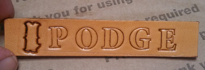

Members LeatherHead99 Posted June 1, 2013 Members Report Posted June 1, 2013 I have no idea if anyone has tried this before, but I thought it may be worth posting. I saw my wife had bought a bottle of " Mod Podge" for a craft project of hers for the kids room. I've use this myself before for other paper craft projects. I thought to my self " I wonder how it works on leather". I tested it on a few scrap pieces of veg tanned leather and let it dry for a couple of hours. I was actually shocked at how well it worked.It left a nice glossy shine on the leather. It resisted water just as well as super shene, maybe better. I tried a tiny bit of Feibings Antique on it, and it resisted it quite nicely. Its a pretty thick substance and tacked up in about 10-15 seconds. Once it tacked up I slightly moistened the sponge with water and went back over it lightly and it thinned the Mod Podge into the same consistency and look as super shene. I even flexed the leather to see if I would get some cracking, but it didn't crack either. I didn't do a rub test or anything like that yet. Disclaimer:: Please do not use Mod Podge as your final finish. I only posted because I though it may be worth looking into further. There's a ton I still haven't learned about leather working and I only tested this on a few scrap pieces, and have no idea how it will hold up in the long run. It may have some kind of negative effect on the leather. Or it may be the next best thing, Who knows.. I will try to post some pics of the practice pieces tomorrow. I have no intentions of using this on any projects, until I test it out further. Quote

Members LeatherHead99 Posted June 1, 2013 Author Members Report Posted June 1, 2013 (edited) Here a pic of the mod podge used prior to feibings saddle tan antique liquid.. (not the paste). Edited June 1, 2013 by LeatherHead99 Quote
