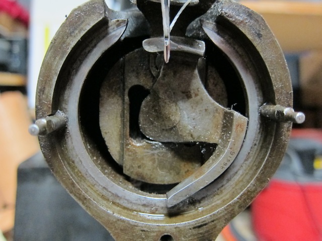

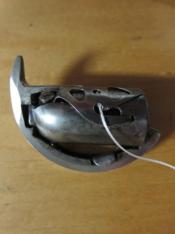

Members courtney Posted June 6, 2013 Author Members Report Posted June 6, 2013 here are some pictures of my hook, is this what its supposed to look like? Also, is this my retaining ring in the machine or am I missing it? Seems to be working since I put the nylon in. Courtney Quote
Members Anne Bonnys Locker Posted June 7, 2013 Members Report Posted June 7, 2013 I would be pulling that bottom end apart and cleaning it out with a toothbrush and kero. The hook surface looks a bit rough in the pic so may need a touch up with 4000 grit wet and dry. Modern threads are much more forgiving than Linen and sometimes minor issues are magnified when using a natural thread so look at the condition of the needle plate hole. here are some pictures of my hook, is this what its supposed to look like? Also, is this my retaining ring in the machine or am I missing it? Seems to be working since I put the nylon in. Courtney Quote Darren Brosowski
Members courtney Posted June 7, 2013 Author Members Report Posted June 7, 2013 Thanks Anne Bonny's locker, is that my retaining ring in the pic? I hope so otherwise I'm missing it. So, the hook looks o.k. To you at the tip? What do you think about the ga5 parts fitting? Are there certain parts that you think tend to wear out? I cant see me breaking a needle plate but it came with one so I don't know, Thanks, Courtney Quote

Members courtney Posted June 10, 2013 Author Members Report Posted June 10, 2013 Thank you guys! thats helpful. Is that my retaining ring in the pic though? Courtney Quote
