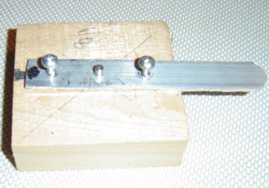

It works, just take the time to make a decent jig.
I use a 3/8 twist bit in a drill press to trim them down.
post-19342-0-93249800-1372122778_thumb.j
post-19342-0-91872800-1372122797_thumb.j
