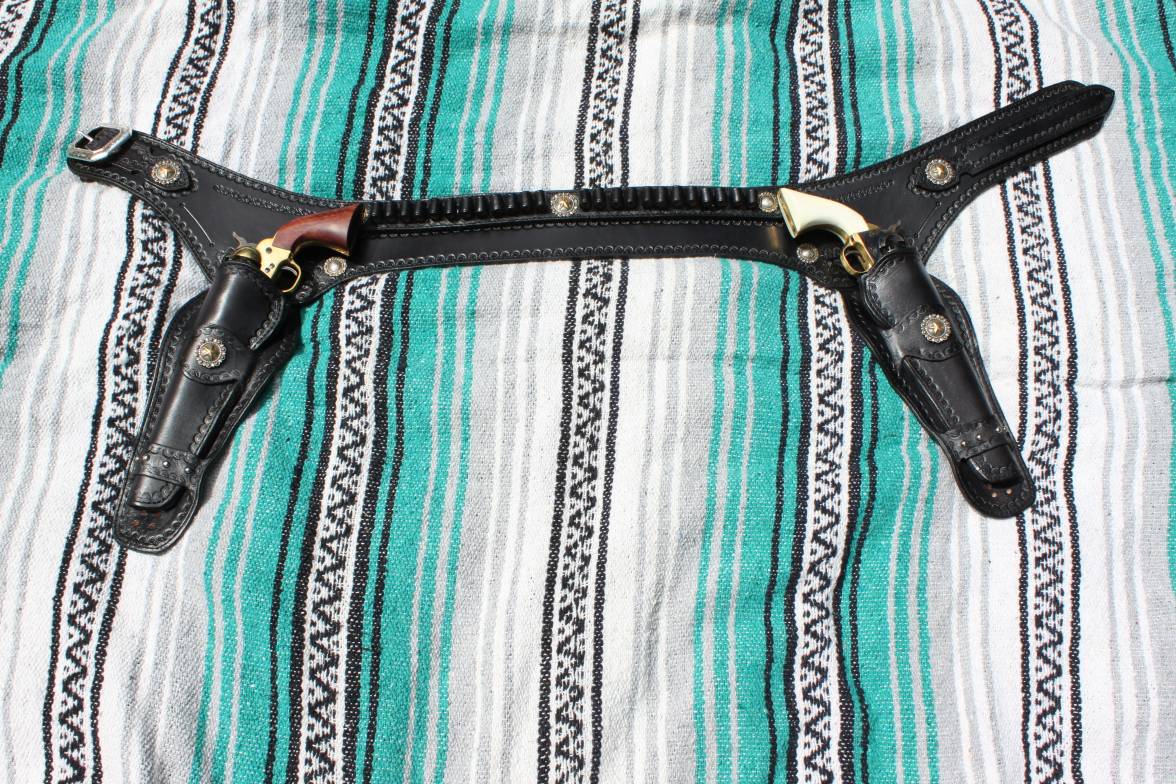

Looks pretty good. The loops might need to be tightened up a bit. They should be tight enough to lock the holster in place so it does not try to pull out of the loop. You should have to work almost force the holster into the You shouldn't have to worry about folding the holste. Once it is in place put the pistol back in the holster and form the holster and loop. If you don't have the pistol use a hammer handle to open the holster up.
Here are a couple of pictures of one I just finnished. You can see the loops are quite snug. These are for 7.5" barrels so I had to almost fold them in half. They op[ened upe and shaped just fine.
post-15001-0-04713600-1373751278_thumb.j
post-15001-0-10609000-1373751292_thumb.j
