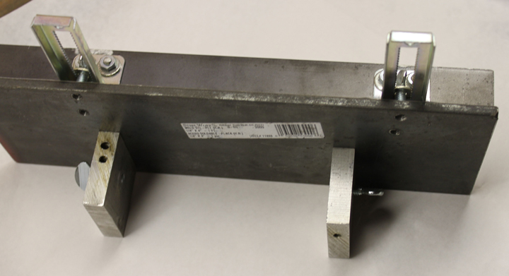

Contributing Member Ferg Posted July 2, 2013 Contributing Member Report Posted July 2, 2013 My explanations of how to do things seem to be less than perfect for some folks but I will give this a shot. You need at least a 2 ton Arbor press. It will be hand operated, your arm will increase in size after you do a pile of these. LOL One piece of steel at least 1/4" x 4" x 12" One piece of steel 1/4" x 1 1/2" x 12" Two pieces of aluminum or steel 1/2" x 2" x 2" Two angle brackets intended for sliding doors (Lowe's and HD has these). One piece of cutting board surface at least 1/4" x 4" x 12" Four 1/4x20 thumb screws 1/2" long. Four other bolts to fasten upright to the angle brackets. A strap end punch of your choosing. Cut the handle completely off the punch and grind the surface level across the top of the cutting edges. You will need a 1/4" piece of steel to match the outer limits of the punch cutting edge. This will lay on top of the punch so the ram of the press has a surface to rest on. If you have access to brazing or welding equipment, the small plate should be attached to punch. You will also need access to a drill press and thread taps. Photo showing table with adjustable back stop. You will need a stop at one end to butt the strap and align the punch. Rear view. Table turned up so you can see the blocks that clamp onto the base of the arbor press. Holes in aluminum blocks are not relevant. Another shot of adjustable angles. You could add another stop to adjust to different widths of strap if you wish. Normally the strap will stay against the back stop while cutting. Tried to make this as concise as possible and still give you enough info to make the jig. The arbor press will not cut more than one strap thickness at a time but this provides you with a jig to cut every strap exactly the same. If I can be of further help just let me know. ferg Quote
